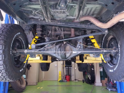

Greetings everyone!
To all who own 3rd gen 4Runners (96-02), planning to lift your rig, I would like to clear up some misunderstandings about the placement and/or installation of the OME 906 rear lift coils. Although many of you probably know this, I on the contrary did not and had to find out the hard way, that the 906 coils are driver and passenger side specific. Essentially, this means that one of the coils (906-A) is approximately .39 inches taller than the other, to compensate for driver side weight. With that being said, the other coil (906-B) is of normal height, which would be installed on the passenger side. I installed them, foolishly disregarding the tags on the coils, then later realizing my rig had been leaning approximately 3/4 inch on the d/s. After calling the distributor, they were of no assistance, stating that the coils are basically the same height. In addition, many people on Toyota forums tend to believe that A belongs on the passenger, and B for the driver because OME is an Australian brand (right hand drive), which may be true in some applications.
So, take your time, do it right the first time, and be safe out there! Hope I could be of any assistance.
-Byron Eby View attachment 751 View attachment 752

My apologies for not describing the pictures!. The more progressive one is the new one. Conveniently, they made the lift coil the same height as the stock coil (the dirty one above the progressive shiny one), however, the progression is so when you lower the vehicle, it is two inches taller.

I suppose if I would have thought for a moment I would have realized one is dirtier than the other!
