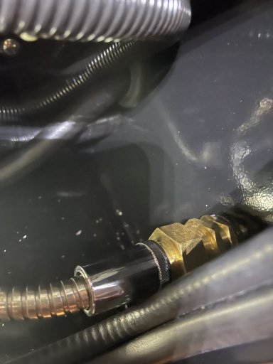

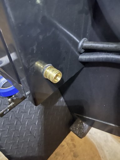

Alright OGT pack. I am not mechanically inclined but super proud of how this turned out. Instead of having to shower with the door to the hot water open I made the mods in the picture. Suggestions welcome. Wife’s nail polish is the prefect shade for touch up paint. It is drying now. I did it with a garden hose quick release so there is not all that screwing going on.

I hate to burst your bubble, but the door has to be open when running the hot water heater, it doesn't have enough airflow without it and with the electronic ignition there's been one owner that I know of that nearly blew the door off after it flamed out due to lack of oxygen and then it tried to relight.
If you want to use the shower with the door closed and without turning the water heater on then that's fine, of course.
Thank you for telling me. I saw that in the instructions but was baffled why. Did not even think of it. Most of the time it is cold water anyways. LoL because I forget to turn the switch to on. But thanks for saving me a door.
I agree that the door needs to be opened to vent the hot water heater, but was wondering if anyone has considered putting additional venting in the door beyond what comes stock to resolve the venting limitations?
Also on our Pando with the CO2 detector the alarm will go off if we forget to leave the door open.
Hmmm...that's a CO not CO2 detector, CO2 won't trigger it because CO2 isn't a health hazard and CO detectors can't detect it. I've found the CO/smoke detector that came with our Pando eats batteries quickly, not sure why but maybe it's because I started using rechargeables and they don't last as long.
Single beep/chirp = batteries dying
3-4 beeps = CO or smoke detected
