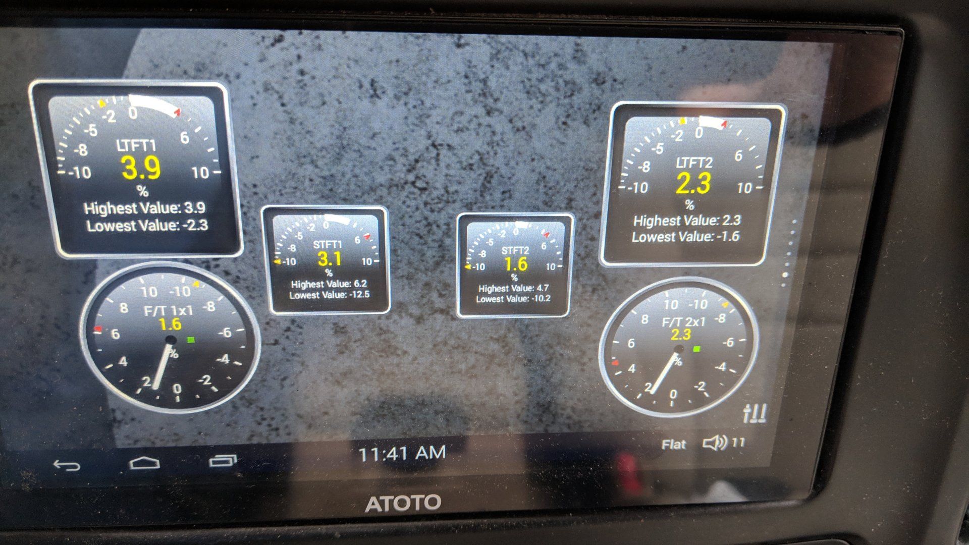

Followed by the fuel trims screen. Short Term, Long Term and plain fuel trim, for both engine banks. I like to watch fuel trims because you can pinpoint lazy O2 sensors, which bank a failing coil is on and if the injectors are having issues. I isolated a miss to Bank1 by watching the instantaneous fuel trims. When the miss would occur the fuel trim would run rich, then return to normal when the miss stopped. In this case, I simply replaced all of the coils on Bank1. Coincidentally, Bank2 started causing problems a few weeks later and got new coils.

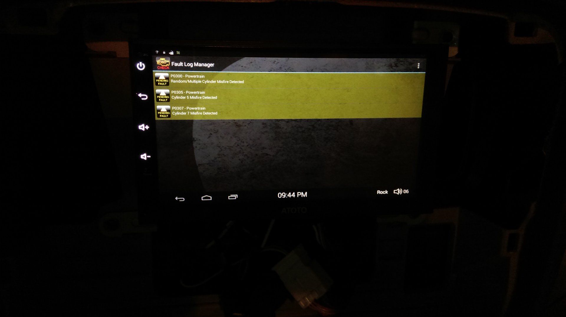

- Very easy to read, clear and research codes that do pop up. It also displays 'gray/ghost' codes if stored in the ECU.
