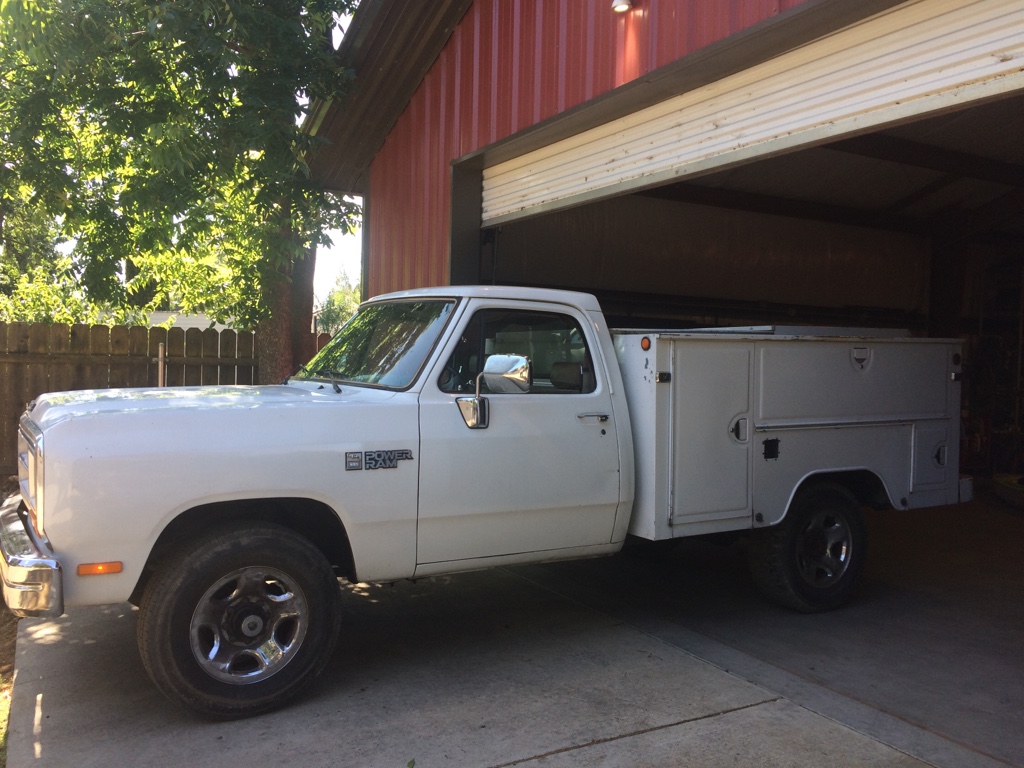

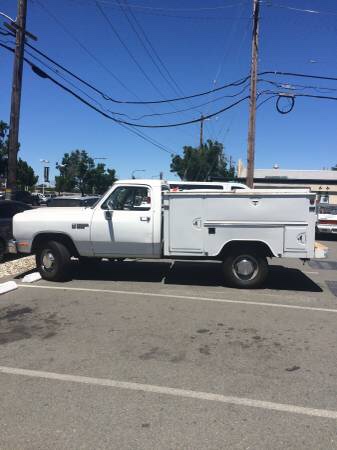

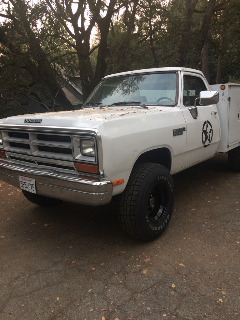

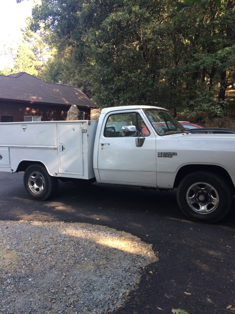

Now I'll start with the first time I laid eyes on her.
Impressive huh??

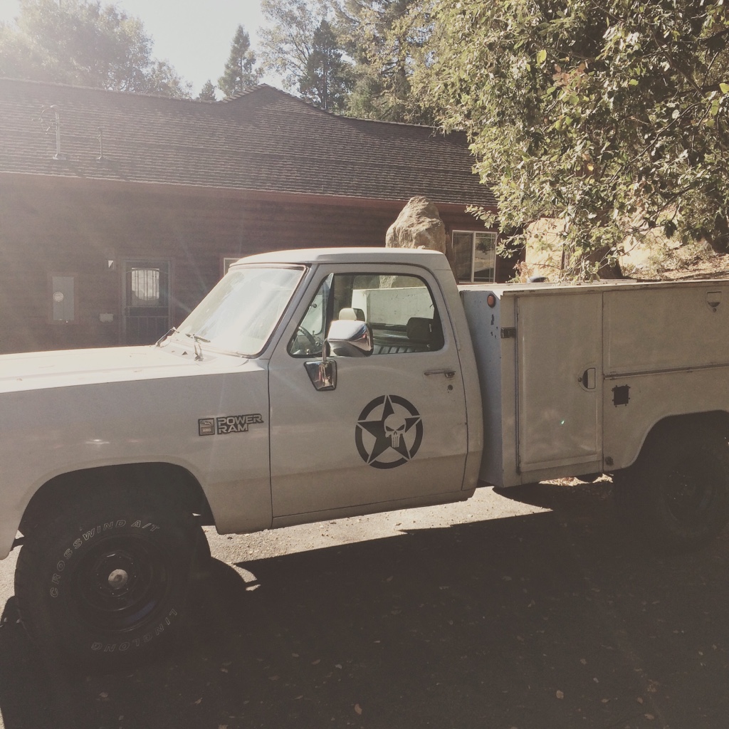

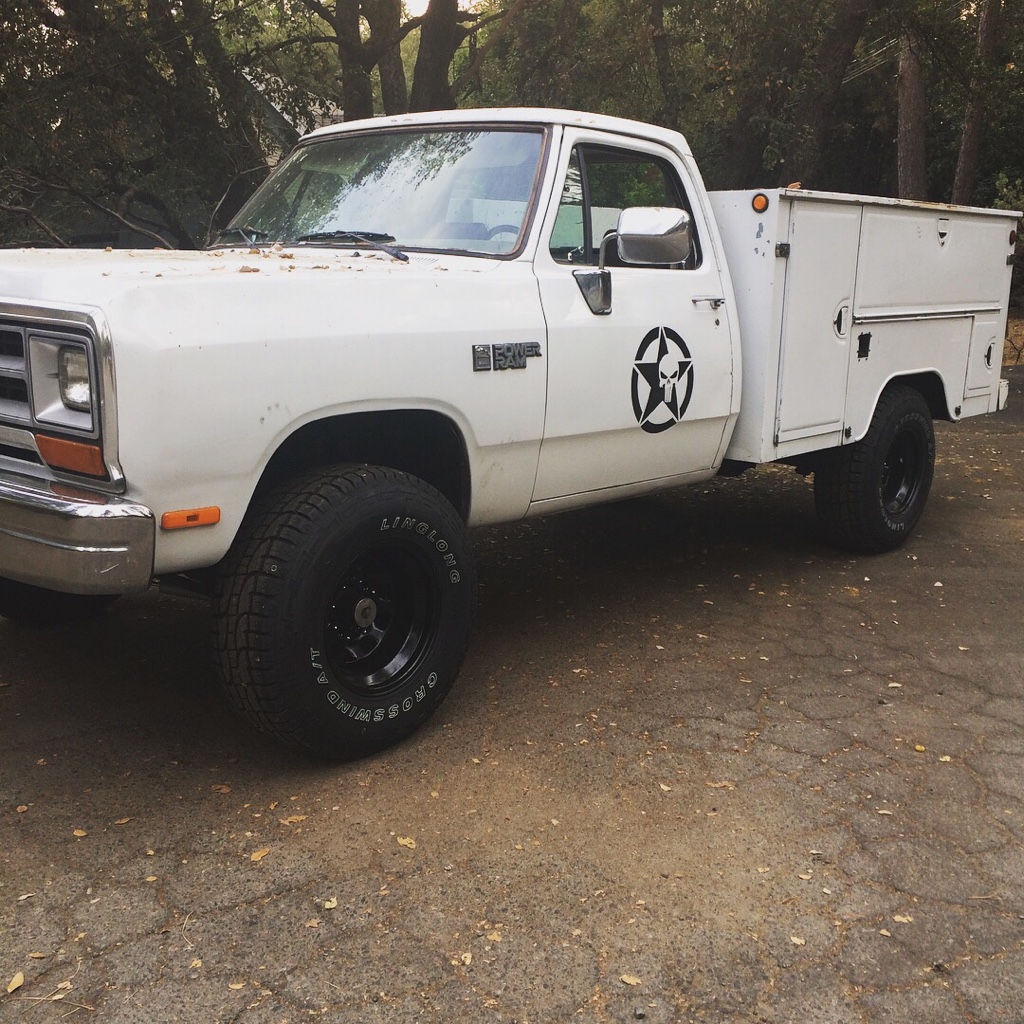

Now you can see the uglyness of this truck. But it's also about how it performs also. First thing I had to is get new wheels and tires. I went with plain Jane steel wheels and a 285/75/16 all terrain tire. The pervious wheels did not have the correct offset which made for some unruly rubbing on every turn.
And boom new wheels and tires plus I added a little skull star to the doors to give it some character.

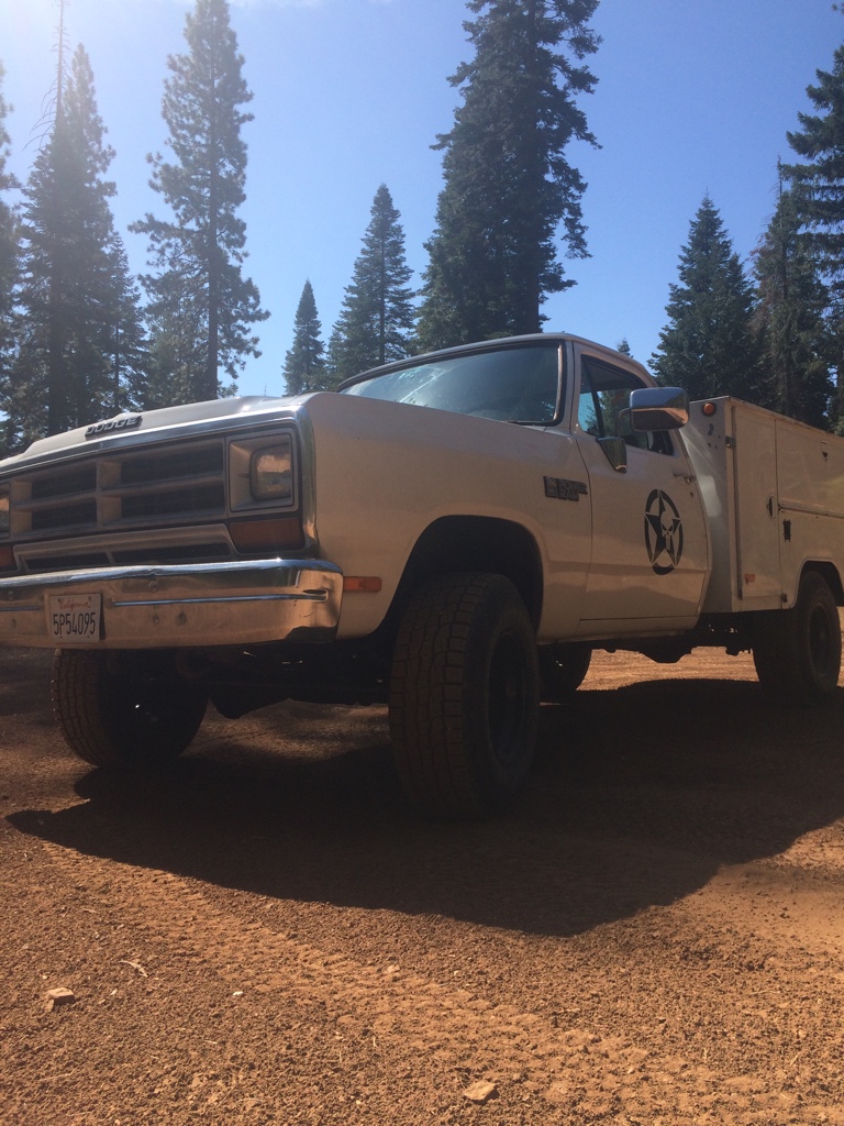

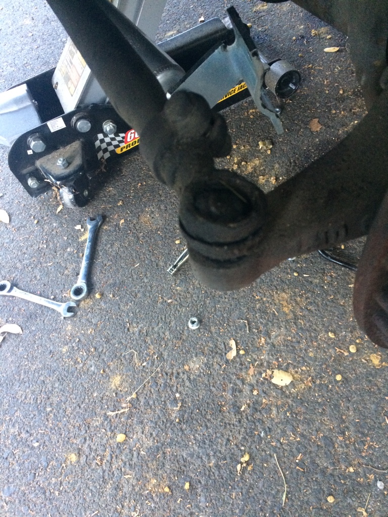

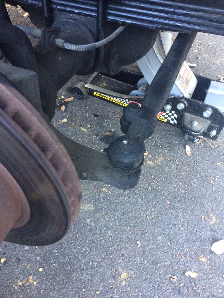

So with new wheels came new challenges that I knew I might have to face but didn't think so soon. Because of the year of the truck, my front leafs had sagged really bad over the years. I still had a rubbing issue. So after some research I went with skyjacker leafs and a 1 ton tie rod upgrade from Ruffstuff. My tie rods were also completely shot.
Super sad tie rods. With the skyjacker leafs giving me a solid 4" higher now, 2.5" higher than stock but my springs were so wore out I couldn't tell how high the truck was gonna be.
You can see it's not to high, I didn't have to change much for steering, just the 1 ton tie rod upgrade which also requires you to taper the old knuckles which isn't to bad of a job. The whole tie rod replacement took about 2 hours.

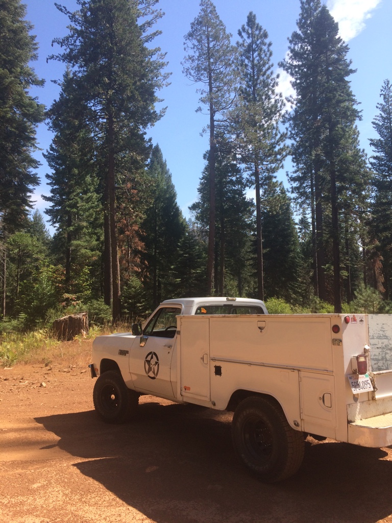

Wasn't a very rough trail but still had to test out the 1 ton steering with Skyjacker leaf springs. Everything handle like I figured but new shocks are a must along with a steering stabilizer upgrade
Also ordered my new antenna for my rugged radio in my truck.
