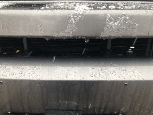

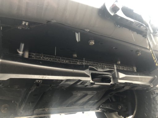

Love the idea of the hidden winch. You were able to do this on the factory bumper? Can you post pics?
Yeah, there’s a write up on one of the Rover specific forums on an LR4, but it’s pretty much the same. I cut out the center section of the factory inner bumper and attached the harbor freight tray in it’s place. I had to mod the outer cover a little, but it’s all inside or very low and not visible unless you get down on your hands and knees. I was not able to reinstall the cover that goes over the front recovery point, but that wasn’t the end of the world to me.
This is the best picture I’ve got in my phone right now. If you want more I can snap some closeups tomorrow.

Awesome- it is on the list of things to do to my LR3- But was balking at the 4-500 plate specific for the LR3.
Thanks,
James
Same here, 4-500 for a hidden winch mount when a lucky 8 bumper is $800? If I ever get done paying for college and weddings I’ll replace the bumper, but until then this works great.
