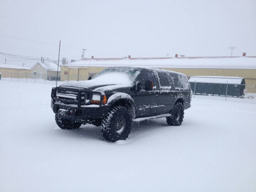

Just wondering if anyone else has built an Excursion. Mine is a work in progress and I'm wondering if anyone has any advice on the do(s) and don't(s) of this platform.
That would be awesome. I've done a good bit, mainly to the engine. New heads, bigger turbo, 190cc 30% injectors, straight piped exhaust, water meth injection, regulated fuel return to keep #7 and 8 loaded with fuel, and all the monitoring to boot. I've got a 5 inch Icon lift, Ranch hand winch bumper with 10K winch running on 35 BFG KA2. I've got a long ways to go until It's complete. If I ever get complete.You know I have a good friend with one, he was building it up for long range runs, however that plan has recently been derailed by some domestic bliss interruptions, however it's looking great.

Shoot man, hope you aren't gone for too long. Stay safe!Sorry for being MIA for a while. I've been getting ready for a deployment (leave tomorrow). I still haven't got the rack built yet. It will have to wait until I get back from the Sand Box. I did add a forth row seat from Little Passenger Seats out in Cali. So far it's great, the only down side is my kids fight over who is going to sit in it. Kind of reminds me of when I was a kid and always wanted to sit in the rear facing station-wagon seat. I also got the Aluminess rear tire carrier/storage box on. I like it, but for what I paid I expected a little more. If I ever get good at welding, I see an "overlanding" business developing.
