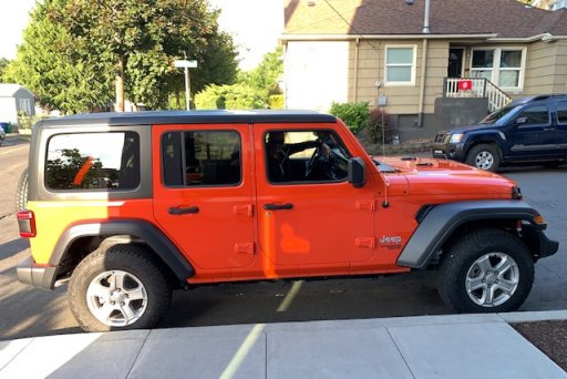

Hey guys - we just got back from the NW Overland Rally and my wife really got the bug , so ... we traded in her daily driver for a 4 door JL Looking at starting on some mods right away. I have a 2018 Runner (TRD Off Road) and have spent the last year or so mod-ing up, but now starting from scratch on the JL. First up are tires and suspension. Wanted to see what y'all out there are running ... and feel free to lob in suggestions on anything else - I've got some work ahead of me! Thanks all!

Thanks Ben and Carter - both helpful. We're just going to be doing some moderate trail running in it, so it sounds like your setups may be a good fit. Thinking about a 3" Teraflex and 35s on the tire. Still deciding on the brand ... I have Nitto on my runner and love them, but a bit spendy.
What's the fix for the death wobble? My wfie will not like that :grinning:
