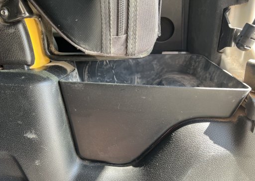

Once I get the filter situation dialed in I have been thinking on the best way to package this all up. I had bought some inexpensive Amazon storage bins for my Jeep JL which form fit to the rear sides of the walls in my cargo area. I only really use them to hold odds and ends as the much more effective roll bar storage saddles block a lot of the accessibility to these bins from above. I am now thinking this would be a good area to neatly house the filters and provide a holding place for the pump when not in use. I have a flat sheet of plastic similar to the bin that I can create a custom sized lid which then I can install a couple of bulkhead water fittings to that will connect water input to the filters and output to the faucet unit. Another benefit with the plastic box is if there are any small leaks water will be contained in that bin tub. On the driver side I have another similar bin for that side which I will be using to house electrics such as an additional circuit with fuse box and surface mounted Anderson, USB, and 12V connectors, etc. but that will be the subject of another build.
