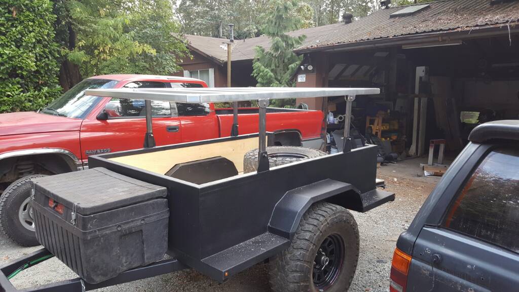

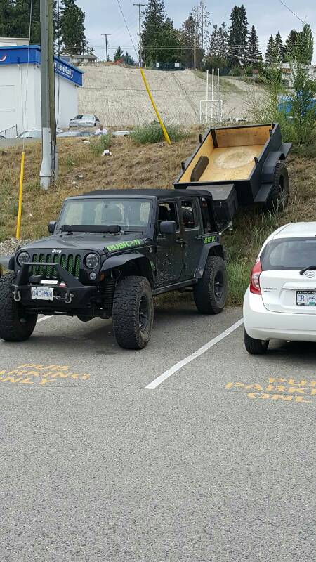

Got the rtt rack and the. Plywood on the inside next step is build something to cook on and pick up the tent later this month
Unfortunately the tent will be later than I hoped as they were out of stock of the one I wanted. So waiting until October for the shipment to come in
