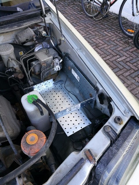

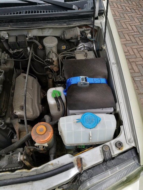

I wanted a second battery for it, so made up a tray and moved the washer bottle a bit. (it was sitting where the battery is sitting now)

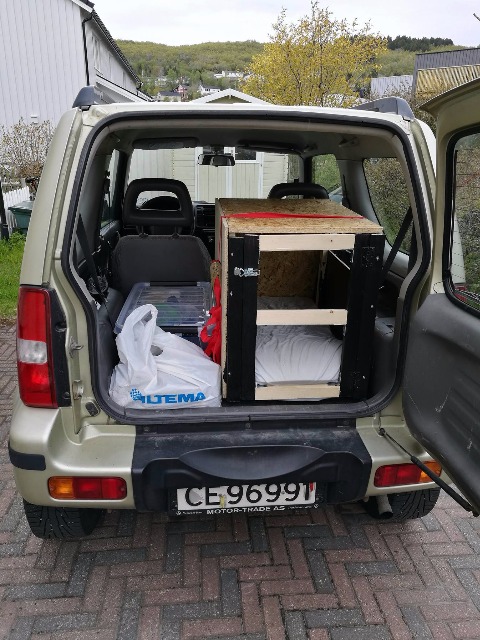

Also started making up some stuff for the back. Removed the rear seats, and made a new insert to have a flat floor. Don't want to bring any extra passengers anyway :P Building a crate for the dog. It is nearly done. Just need to carpet it and mod the door a bit more. And also making up a shelf over the plastic box there, so I can bring an extra and easily pull them out. Or just to bring one, and let the rest of the luggage stay on top. Hate having to take stuff out, to get to other items under them. Need to level the boot floor a bit.
