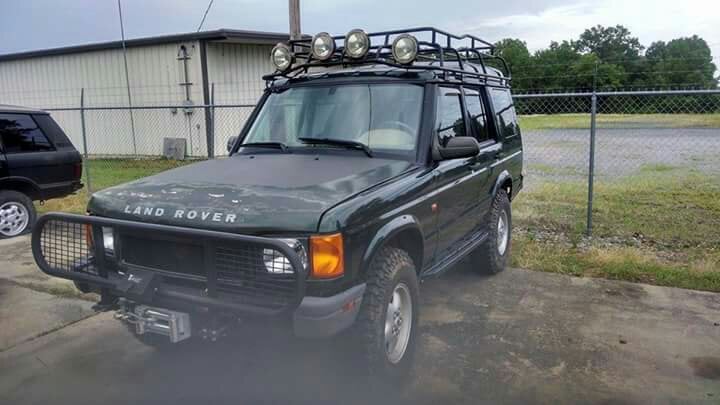

My Land Rover from when I got it to date
2001 Land Rover Discovery LHD
4.0 V8
R380 5 speed Manual transmission

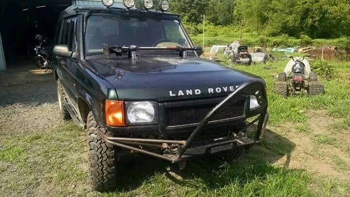

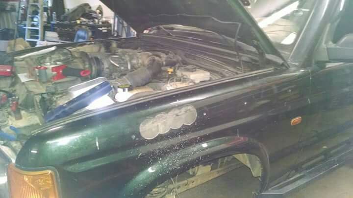

Here is how it was the day I bought it.

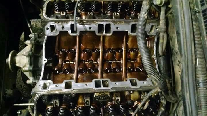

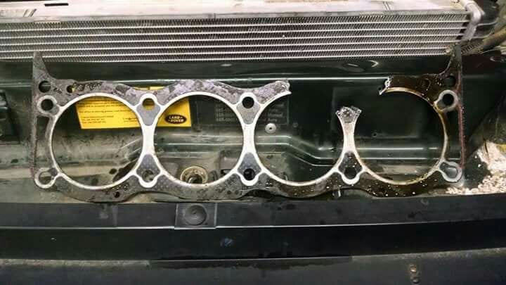

It had a blown engine when I got it.
Sold the bumper tires and roof rack to fund my repairs

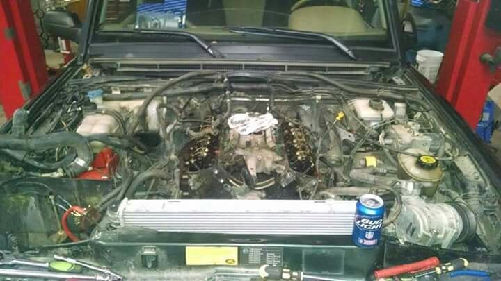

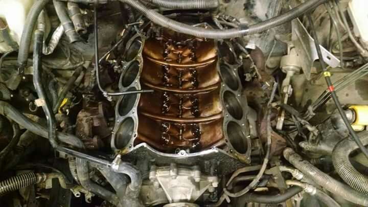

I resealed the engine, all but rear main seal and replaced cooling components.
It had a slipped liner on cylinder 5 and blew the threads out of a head bolt hole.
I had to drill tap and coil the one hole, top between cylinder 5 and 7

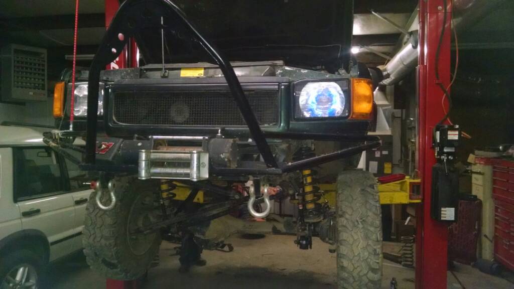

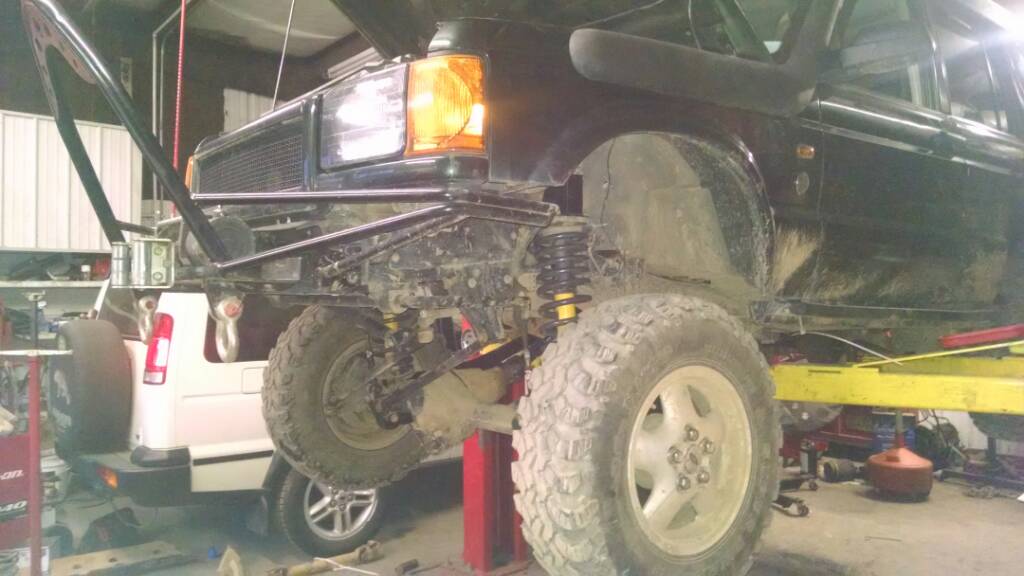

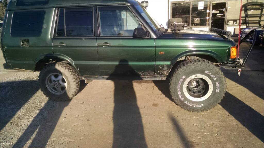

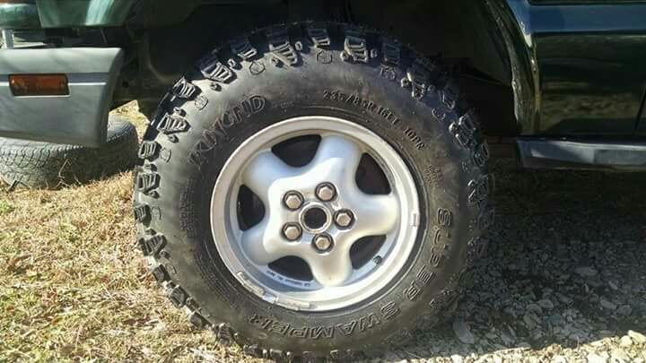

Got new tires and was on the road again, also put Hi lift jack on hood.

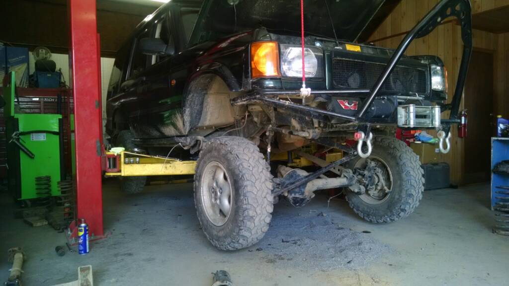

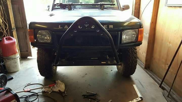

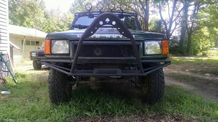

Custom bumper made
And winch

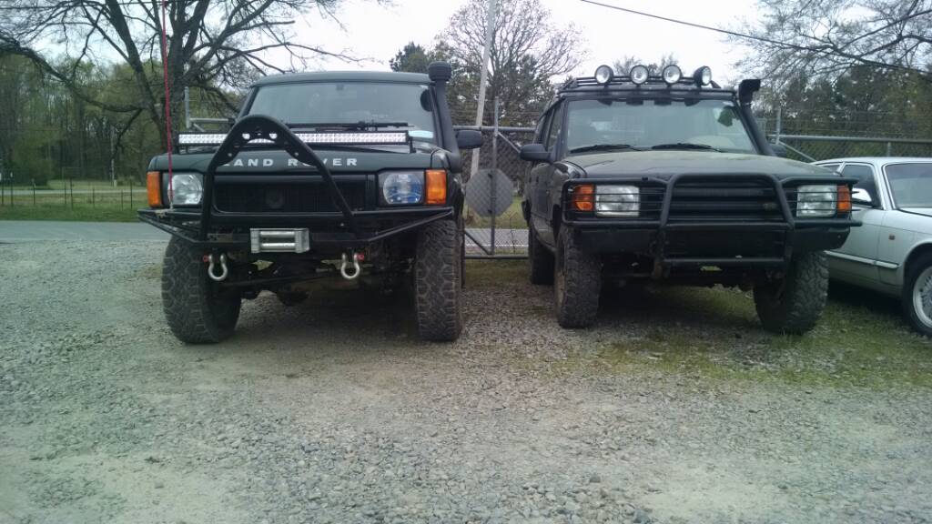

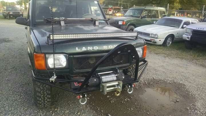

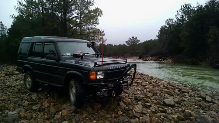

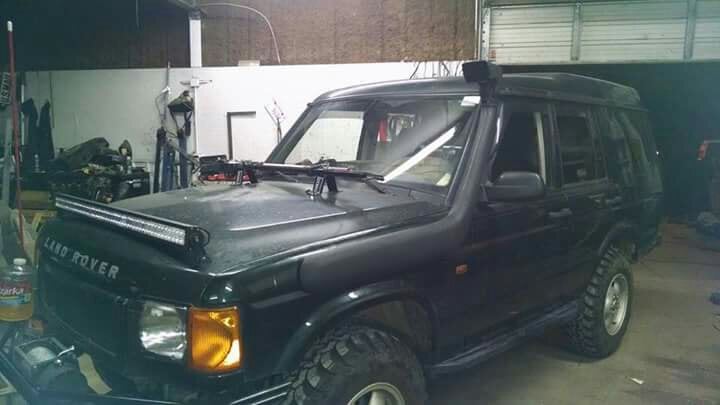

Light bar and snorkel are latest additions.
This is its current configuration at this time.
Drive it everyday, hasn't let me down yet.
Will need a new motor eventually, I'll do a complete drive train overhaul when that time comes.
