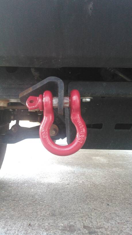

I just got mine delivered. From what I get this is a simple bolt with the stock bolts but do I need them torqued to a specific spec?

That recovery point seems a little on the light side. Is it a 2 or 3 point attachment?
The attachment bolts also seem SMALL. My personal opinion is that it is marginal, and should only be used in a BRIDLE configuration. A better product design is the ARB . But it is only available for Toyota in this country. There are a couple of companies that import other similar design recovery points.
4Wheel Drive Action (Australia) HAD a recovery point failure with a similar design.
It's the same bolts for a stock recovery hook on the TRD. Anything can fail.

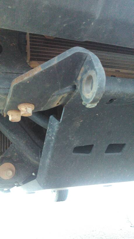

True...but that photo you submitted shows a 3rd hole, that has a RUST-RING halo where a 3rd bolt once was. I would at minimum put in some GRADE 8 bolts in all 3 attachment spots to the frame.
This would be cheap insurance, and increase the safety factor for all invoved.
They are metric equivalent to a grade 8., Like at 10 something in Japanese standards. Look it years ago. It's all good.

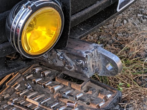

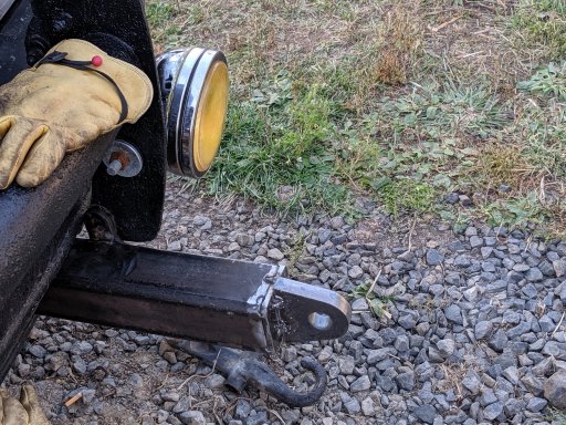

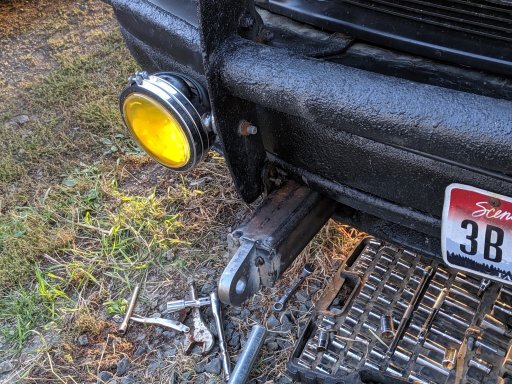

You have to have a good recovery point on your vehicle before you can recover from something.
I went the DIY route on mine. These photos are from the first mock up fitting. They were just quickly tacked together with a 110V stick welder so yes, they look dangerous in the pics...lol.
They are made from 3" x 3" x .250 square stock with .250 flat stock where needed. I can't find the finished product photos but you get the idea .
