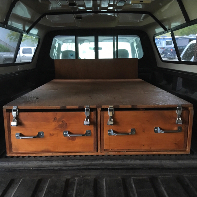

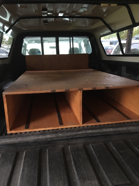

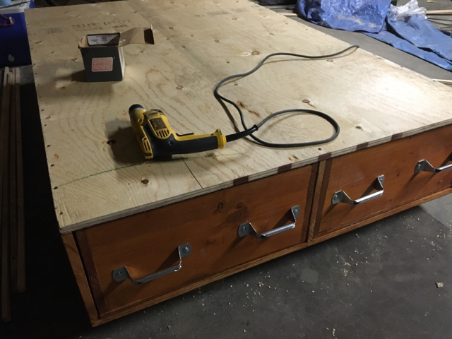

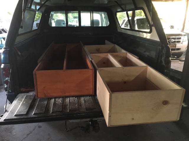

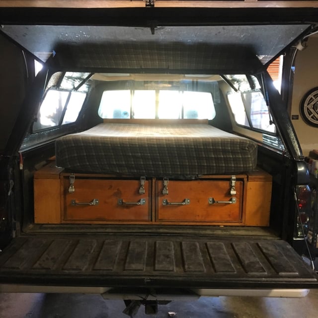

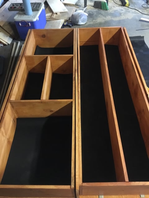

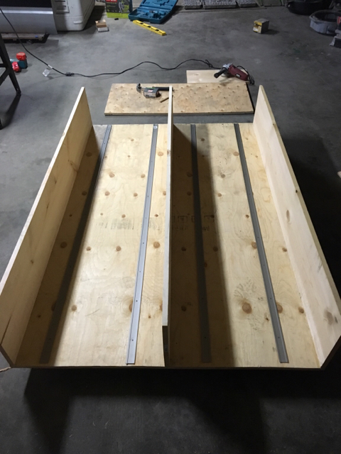

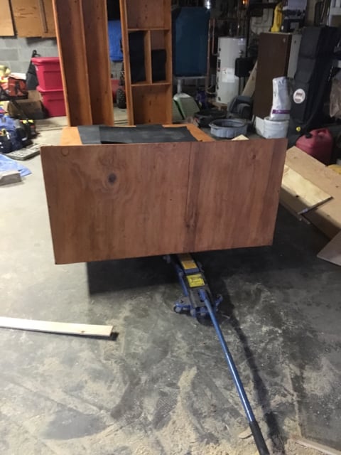

1st thing up: Creat more storage space. How did I do this? I decided to build my own drawers for the bed of my truck. Spent about $500 in supplies & hardware to do this over a couple weeks. Beats spending well over $1,000 in my personal opinion. I will start by just posting the final product and will post some more detailed pics upon request.
-cdn.com/20170110/cdfffcbfaa70f6fb9ac737843a7a3f5c.jpg[/IMG]
Anon
For now, I have my old full size mattress in there until I can make a custom bed out of a 3-4" memory foam mattress. Will be using the memory foam as a bed to save on head space as I do not want to raise the canopy upwards and because I want it easier to remove if I need to haul something for just everyday use. Overall, this thing easily added a 100-150lbs of weight to the bed of my truck (empty). I used a little above average wood, stained it, and popped it in. It is not currently bolted to the bed, but may be in the future to prevent a yard sale in a worst case scenario. This thing is far from seeing that kind of abuse though. For now... [emoji48]

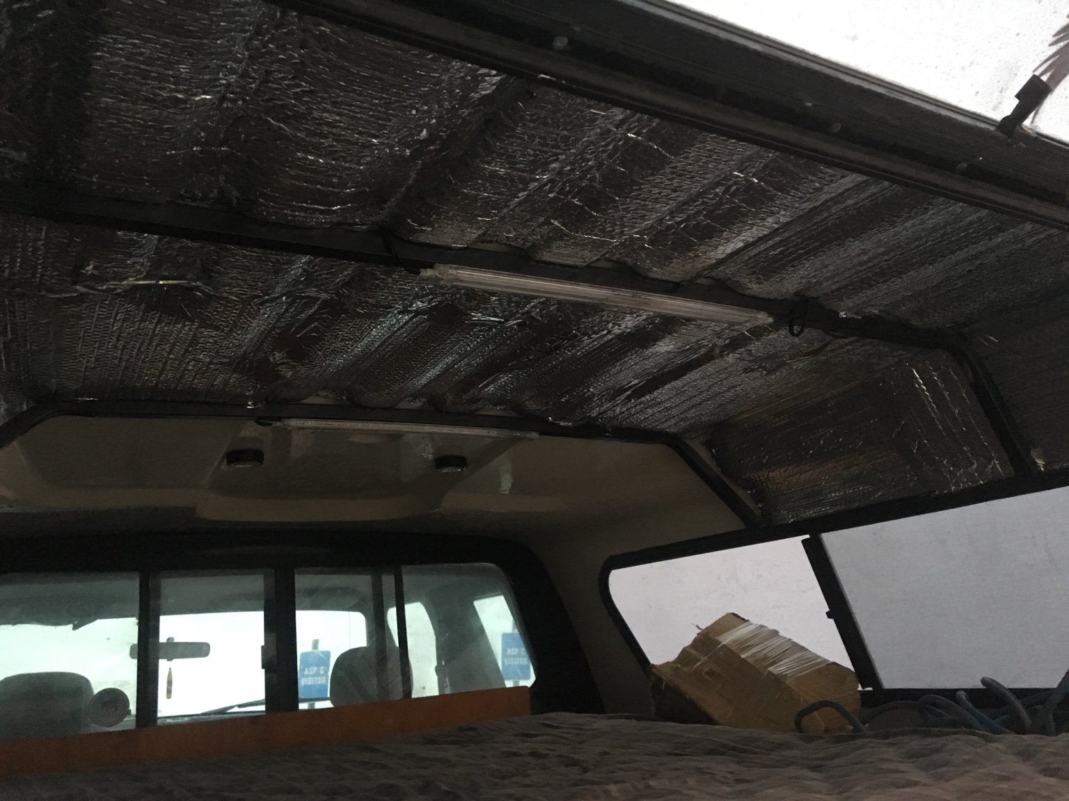

The type of insulation I used was reflectix. Supposedly a pretty good insulation and has proven so in as cold as 0°-10° weather. I started this process back in Oct 2016, but ran short of funds and then got distracted buying other stuff with the upcoming holidays at the time, but will be finishing within in the next week once I get my next paycheck in, so stay tuned for that.
So far, the half that is insulated, has made a pretty significant difference in warmth retention and has done well at deterring moisture from building up on the inside. For those who are considering doing the same thing, I recommend gluing the reflectix on using Liquid Nails. All in all, it's a very affordable and effective way to go. It's worked well for me so far and the reflectix hasn't budged since Oct 2016.

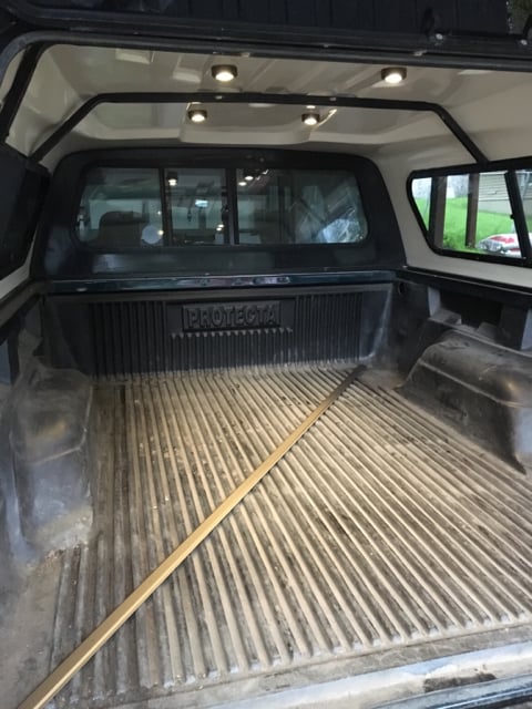

As you can see from those pics, I also have a couple different forms of lighting. Although, the two smaller ones you see will have to be reattached once I insulate that half of the canopy.
I decided to go with 2 options.
1) 2 18" Slim LED strips I picked up from Lowes that are also considered Energy Efficient and use little to no power.
2) Push activated, battery (AAA) powered lights. These are more of an easy on the eyes kind of light and are located in an area that is easier to access when sleeping in the truck.

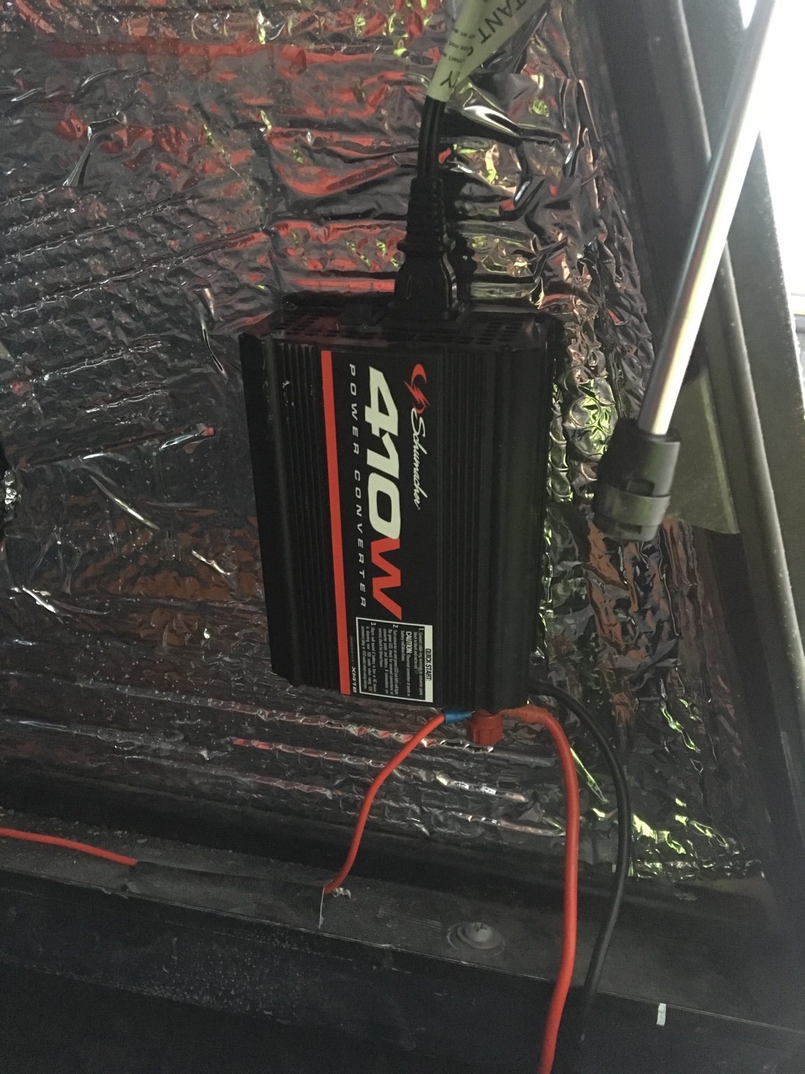

I power the lighting with a hard wired 410w inverter. This is a temporary inverter until I have the money to invest in solar panels and a 2-4 battery power bank as at one point in the future, I will also be installing a small tv monitor and an Xbox. Xbox would mainly be used for movies, but I also have a long term goal of installing Wifi in the truck so I can also play games online or stream a video here n there if I am somewhere with service. Would also be good for accessing maps if need be.
The inverter has 2 12v plug ins and 1 USB plug. I ran the wires all the way to the battery in the engine bay to get the maximum wattage possible from the inverter.

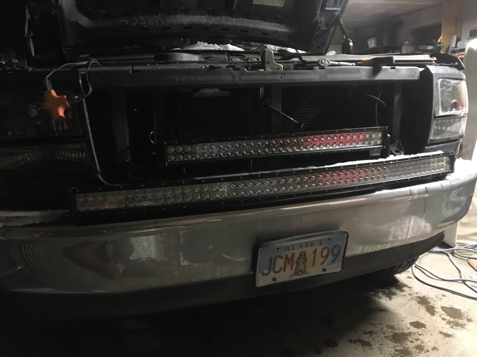

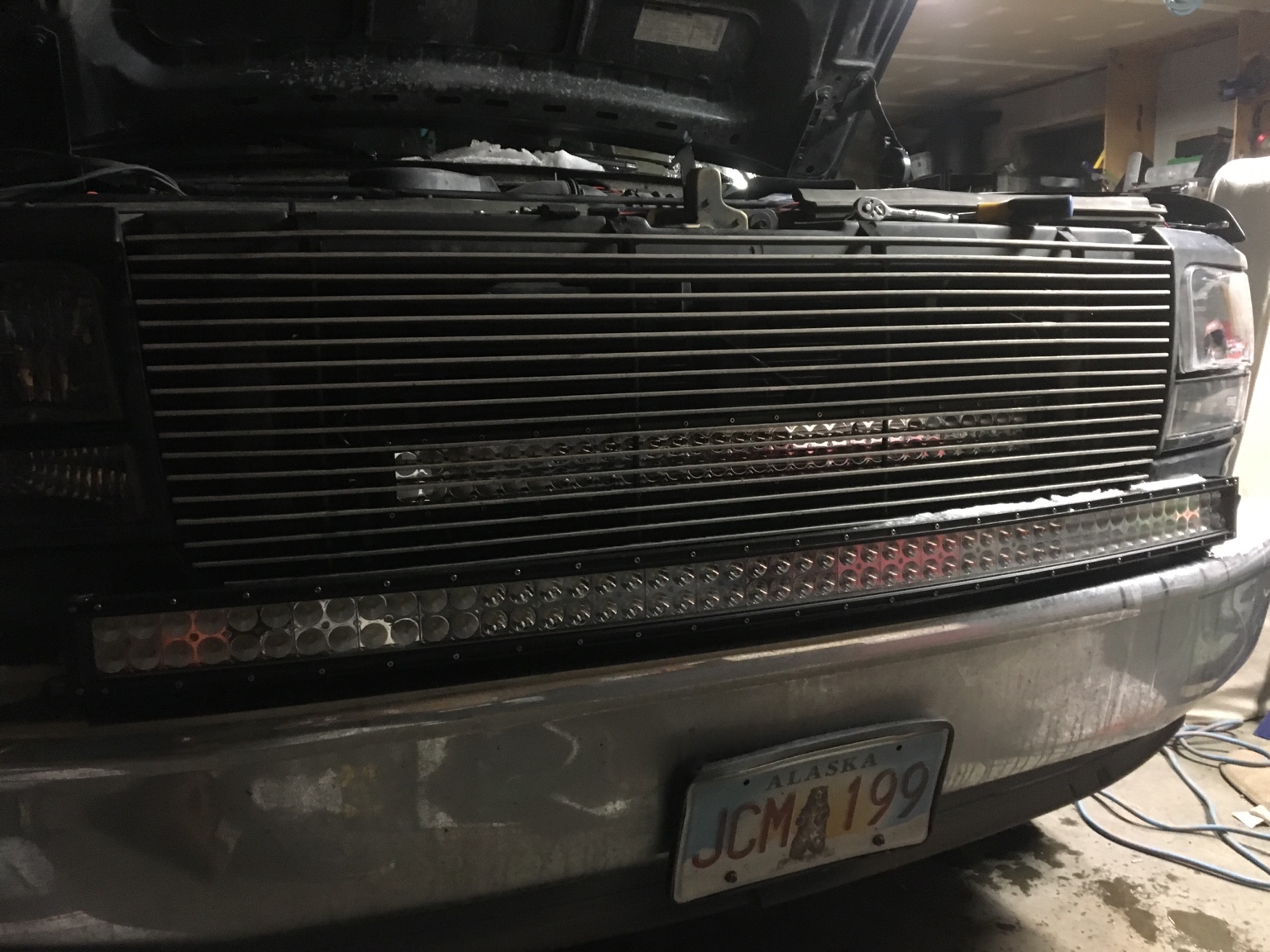

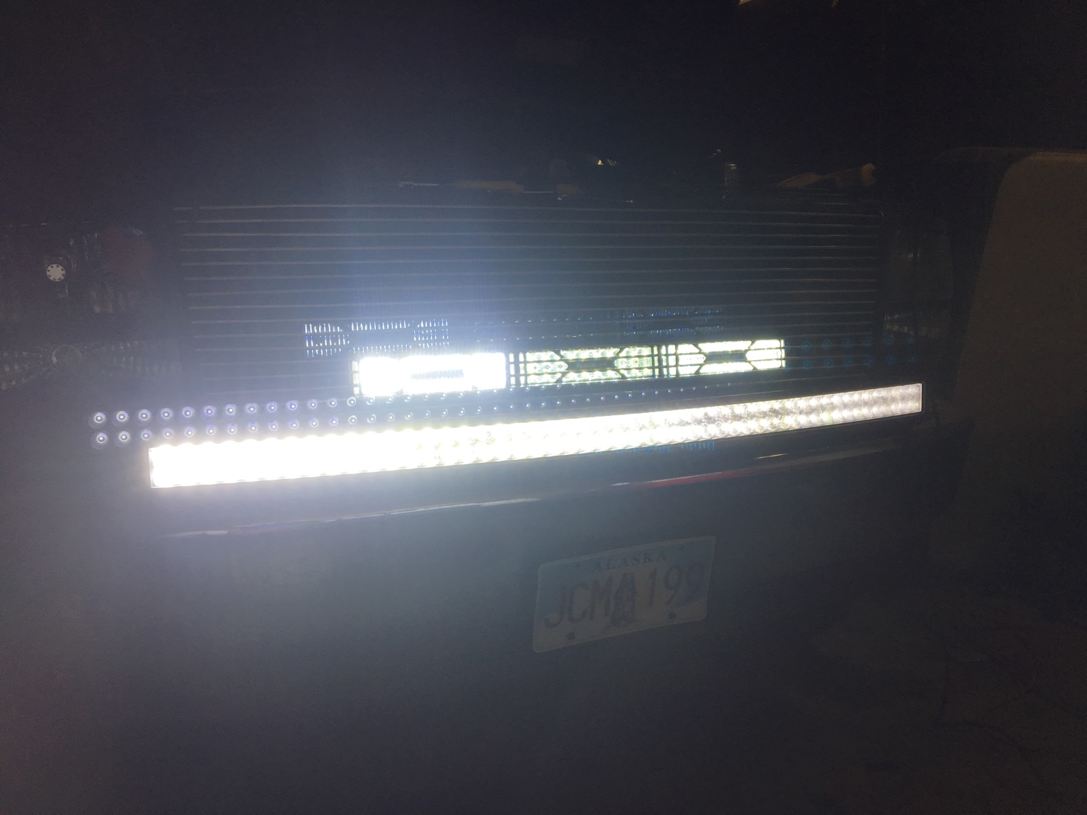

Then for Christmas, my girlfriend went all out and bought me 2 light bars. The first one being a Senlips 52" Curved LED Light Bar (white) and the 2nd one being a Liteway 32" LED Light Bar that put out an Amber color, White, and strobes in both colors. All on a remote.
I just got done installing these and they make a HUGE difference. However, I can not run anymore aux lights confidently until a buy a new alternator & wire in my dual battery set up. Next up (lighting wise) is 4-5 Spot Lights across the roof, 2 lights off either side, and one out back.

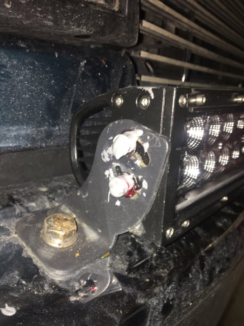

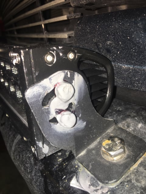

Have a pretty big problem with theft where I live so I have to take every precaution I can, so to prevent the 52" from being stolen, all the bolts visible are shaved and encased in JB Weld while also using the strongest thread locker I could buy locally.
A little ugly looking in the pics, but it cleaned up nicely.

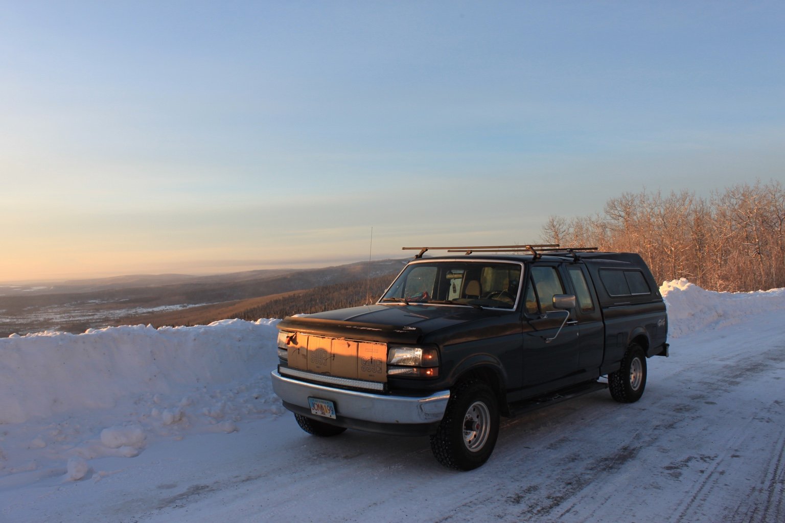

Bought myself a Thule Roof Rack about a week ago. Finally got around to uploading the picture off of my girlfriends camera. Good shot of the rig too [emoji1305]. This is in the middle of bun-f**k no where between Anchorage, AK and Chena Hot Springs out of Fairbanks, AK.
Went from 9° to -30°. Took this pic in about -25° weather.

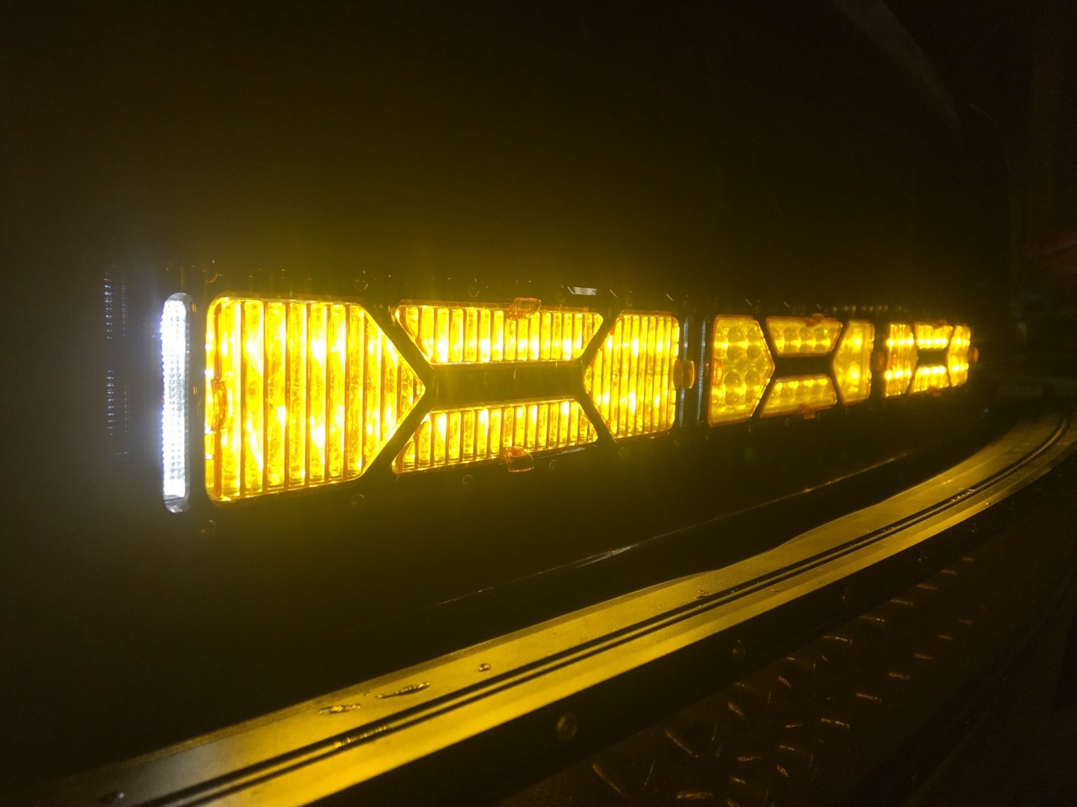

Well, yesterday was the day I finally decided to install my new 32" Auxbeam LED Light Bar. Loving it so far and supposed to get Amber lenses in by the 30th.
I'll try n post a better pic later on and will post detailed pics of the wiring job upon request.
