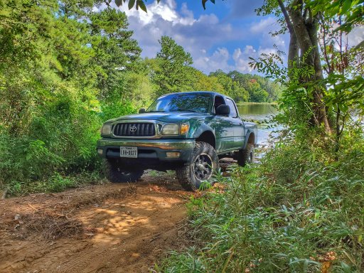

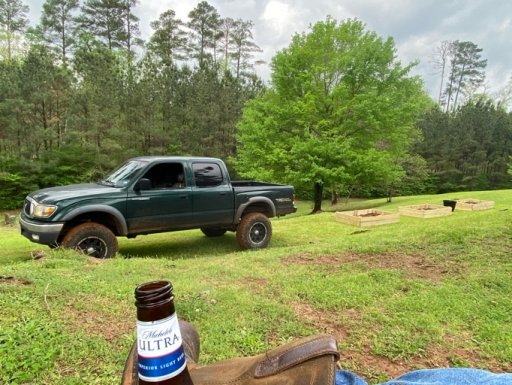

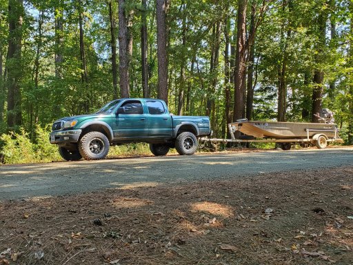

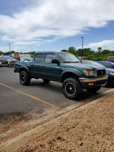

Heres the truck the day i picked it up. Its a 2001 tacoma double cab sr5 trd. The build will be used to pull my gatortail mud boat and be my base camp while out in public land hunting and just enjoying the outdoors with my wife and kids.20190411_183829.jpg

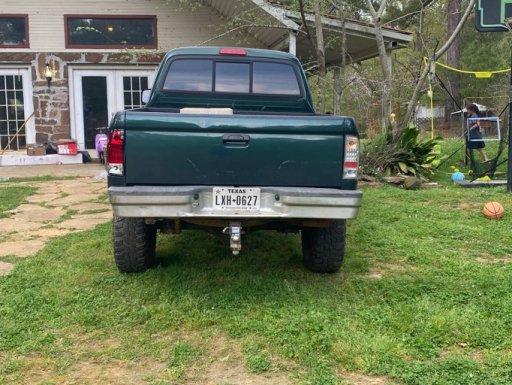

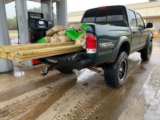

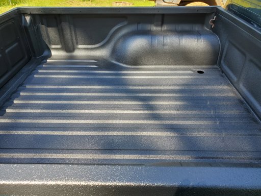

After the wash job decided to remove the plastic bed liner since it was showing signs of rust on top of the bed rails. When i removed the bed liner i had about a fifty cent piece sized hole rusted thru the bed. . So after a little cutting and grinding. I welded some plates top and bottom over the hole. Then off to have a spray in bed liner put in. 20190514_104433.jpg

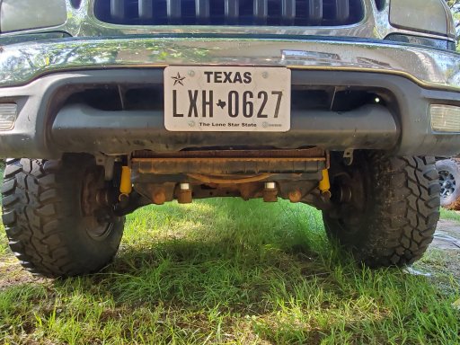

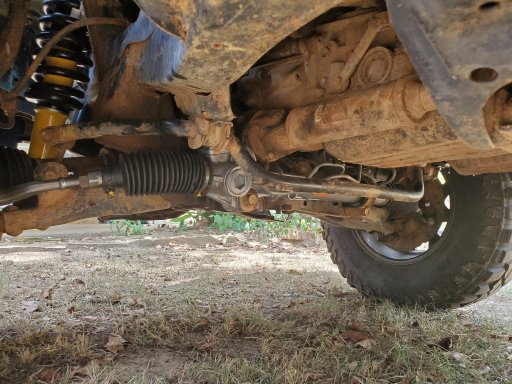

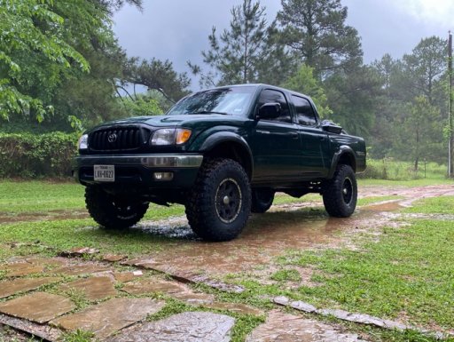

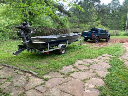

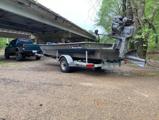

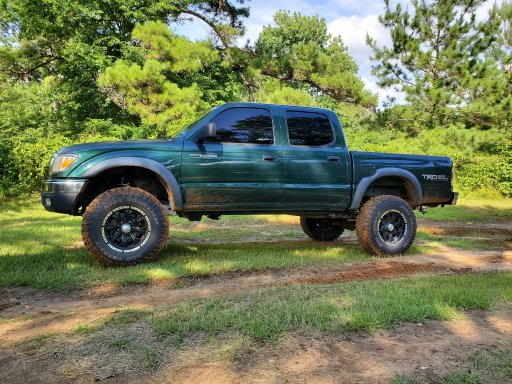

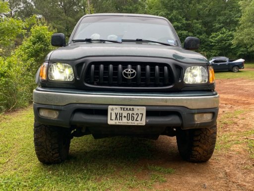

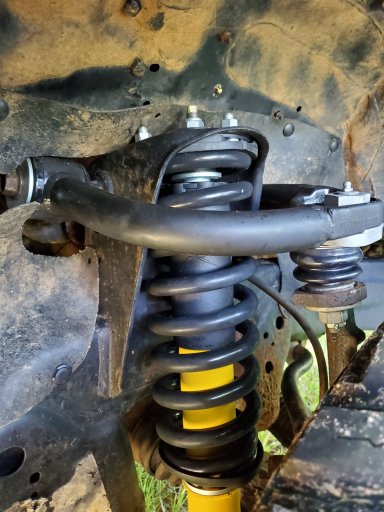

Did some suspension work this time i was off. Front got ome, spc adjustable control arms, and diff spacer. Rear got progressive add a leaf pack with ome. But while doing the suspension found my rack and pinion is getting weak so that will probably be my next project.20190617_083119.jpg20190617_083208.jpg20190617_171118.jpg

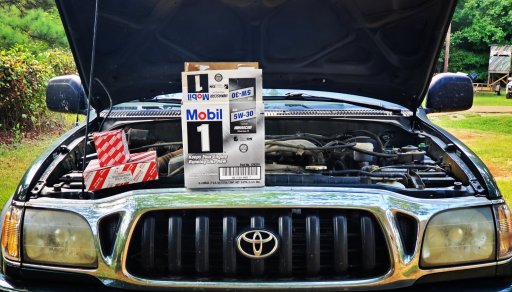

Well my rack and pinion, inner and outter tie rods, and poly bushings didnt make it in in time for me to get them installed this time. The ole hunting taco did turn 200k though so gave it a oil change.IMG_20190718_095328_661.jpg

Got the new rack & pinion and tierods installed this trip. Man what a difference in the driveability of the truck. That rack and those tierods was definitely shot.20190812_160636.jpg
