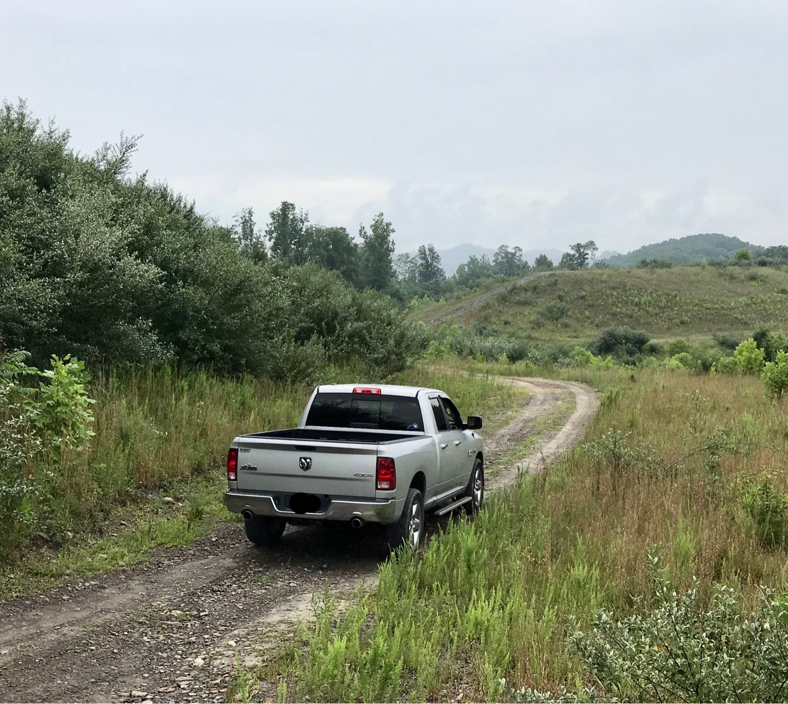

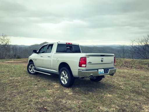

So here it is, my bone stock 2014 Ram 1500 Big Horn 4X4. This rig will have to wear a lot of hats, but I hope to find a balance that allows it to serve as a competent weekend over landing rig. I have a long list of ideas for mods, but I think first up is going to be bilstein 5100s set to 2.1" and some yet to be determined allterrain 275/65 for the factory 20s. I've got some basic camping gear that I have used to car camp out of my old Subaru. I am hoping to update to some more vehicle specific gear as the bank account will allow. But for now I am thinking lift, tires, and recovery gear as a good place to start.

And like truckerbizz says the stock ucas are junk i know the 14 and aboves are notorius for popping balljoints. So far mine have held up with no sign of the balljoint giving but i have an early in the year 13 and havent really done anything to crazy with it

Thanks! Yeah, Truckerbizz gave me a pause, but I am thinking it shouldn't be as bad if I set the Billies to 2.1" until I can swing some UCAs. I am only trying to run the 275/65R20, which is roughly a 34" Tire. Thought about the 35x12.50's, but I think that might be asking a little much of the 3.21 rear gear. I know some loss is unavoidable, but I don't want to give up too much performance/MPG.

Yea just keep an eye on your balljoints like i said mine have been fine at 2.8 and i feel ya i have 3.55 but with the 6 speed so im looking into the 275/65s as well in mud terrains

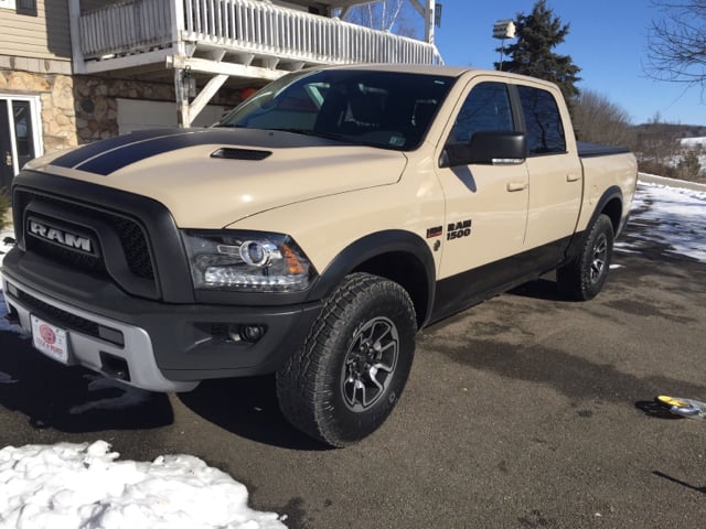

I thought I'd build out my 2016 RAM 1500 CC eco-diesel only to find there's not much out there to choose from. But with 34,500 miles clocked in 10 months the e-d engine was too unreliable (entire fuel system replaced @ 18k miles, it's been drinking the coolant everyday and been in the shop five times in five weeks b/c no cabin heat while driving in -5 to 38 degree temps) for me to sink anything into mods.
Picked this '17 Rebel today
