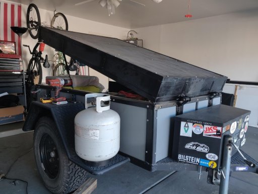

Last week I dropped off the trailer to get the RTT rack built. Decided to go with some bent steel tube to keep it simple. The fabricator did an awesome job and used 1.5" .120 wall to make the U shapes going from front to rear. He then notched some tube to connect the two sides. All in all I am extremely happy with the rack.

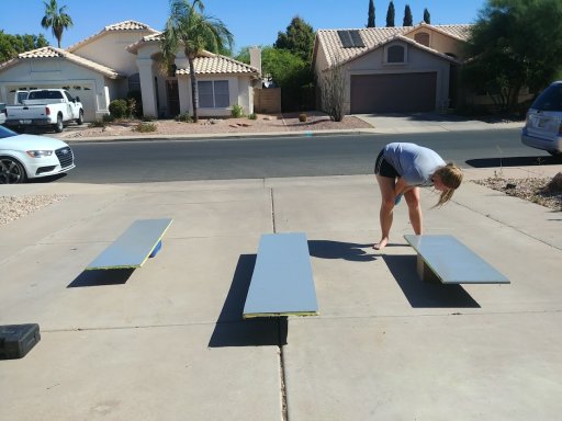

Once I got it home I immediately started painting the rack. I also decided I wanted to cover the top of the lid in Rustoleum spray on truck bed liner. Didn't get any pics but I used two cans and like the texture.

Next up was setting up and installing the Smittybilt Overlander 2783 Rooftop Tent I purchased back at Black Friday!
Setup of the Smittybilt was pretty straight forward and I must say, the quality and value of the tent have so far exceeded my expectations. I really like the included LED strip lights and power ports which will work perfectly with the trailers power setup.

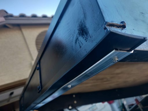

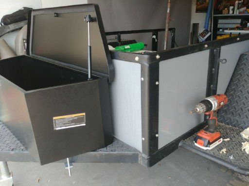

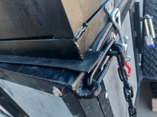

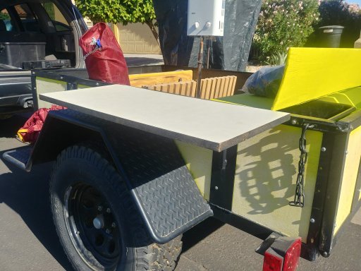

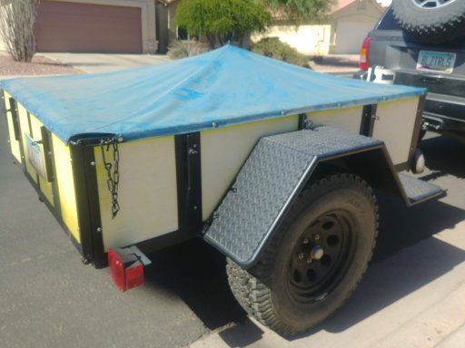

And one last upgrade that work out amazingly considering it wasn't planned..
The wood on the side of the lid cracked a little during construction in 2 places. The tolerances were just too tight and when forcing them into place the cracked slightly.
While cruising around ole Harbo Freight, I noticed these 4" strips of rubberized diamond plate. Well wouldn't you know it, that when building lid I built a 4" gap between the top and bottom rails...
Took 13 sections to go around the trail and I am pretty happy with the results. Especially considering how well it matches the diamond plate fenders.
View attachment 90021View attachment 90022View attachment 90023
