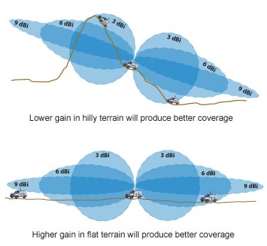

The below image may help show a use case for each antenna.

3db vs 6db uses will depend on your environment. 6db flattens out the wave pattern to increase range and is better over flatlands. If you are more in mountains and the people you communicating with are at different elevations then a 3db may be better.
