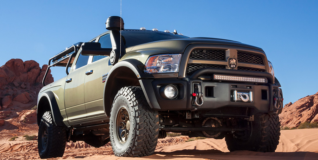

The following are the pros and cons of the AEV / Warn / Mercenary
1) Warn Ascent
Pros
Very cheap coming in under 1400
Winch access is easy to get to
Lightweight metal
Intercooler / Skid plate protection
Has built in lighting options
Winch drops in without removing bumper
Cons
No one has this bumper so its hard to actually determine any measurements or clearance
Frame warranty
Not as beefy/strong
Only bottom mount winch limits it to 12k Capacity
2) AEV Bumper
Pros
Clean looking
Semi Decent Winch Access
Front mount winch plate with 2 bottom mounts for Full frame winches ie. 16.5 TI
Heavy Duty
Modular
Cons
Ground Clearance increase
Cost to Purchase and cost of full frame winch
Lack of Intercooler Protection
Heavy 250 LB bumper
Pain in the ass to install
3) Mercenry Offroad
Pros
Cleanest looking Winch bumper
Flows with body
Foot forward winch mount
Best approach angle
Full skid protection
Cons
SUPER EXPENSIVE $3000 worth of expensive
Have to relocated solenoid for winch
Have to clock the clutch of the winch
Unpainted
