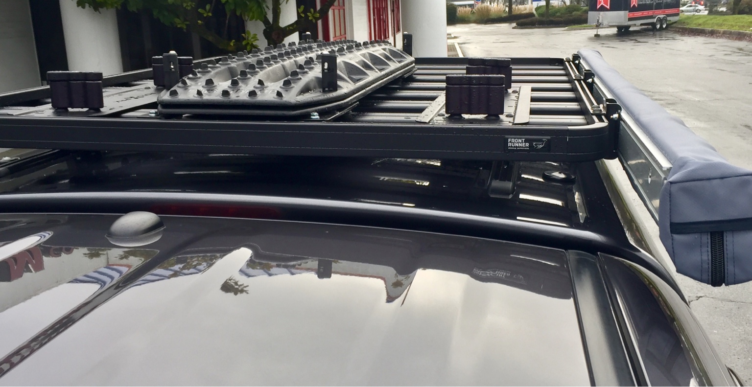

Another option that could work for a lot of folks:
FourTreks
I talked to the owner on the phone this week, really friendly guy, and he says he has a specific mounting option for MaxTrax. He doesn't actually have them on the website but you can probably get an idea of how they work from the product in that link. Basically, he has multiple sizes of tube clamps with a bracket that attaches which has holes spaced at the proper distance for MaxTrax pins or bolts/wing nuts. He doesn't supply pins/bolts. I believe he said $120~ for a pair.

Exactly.

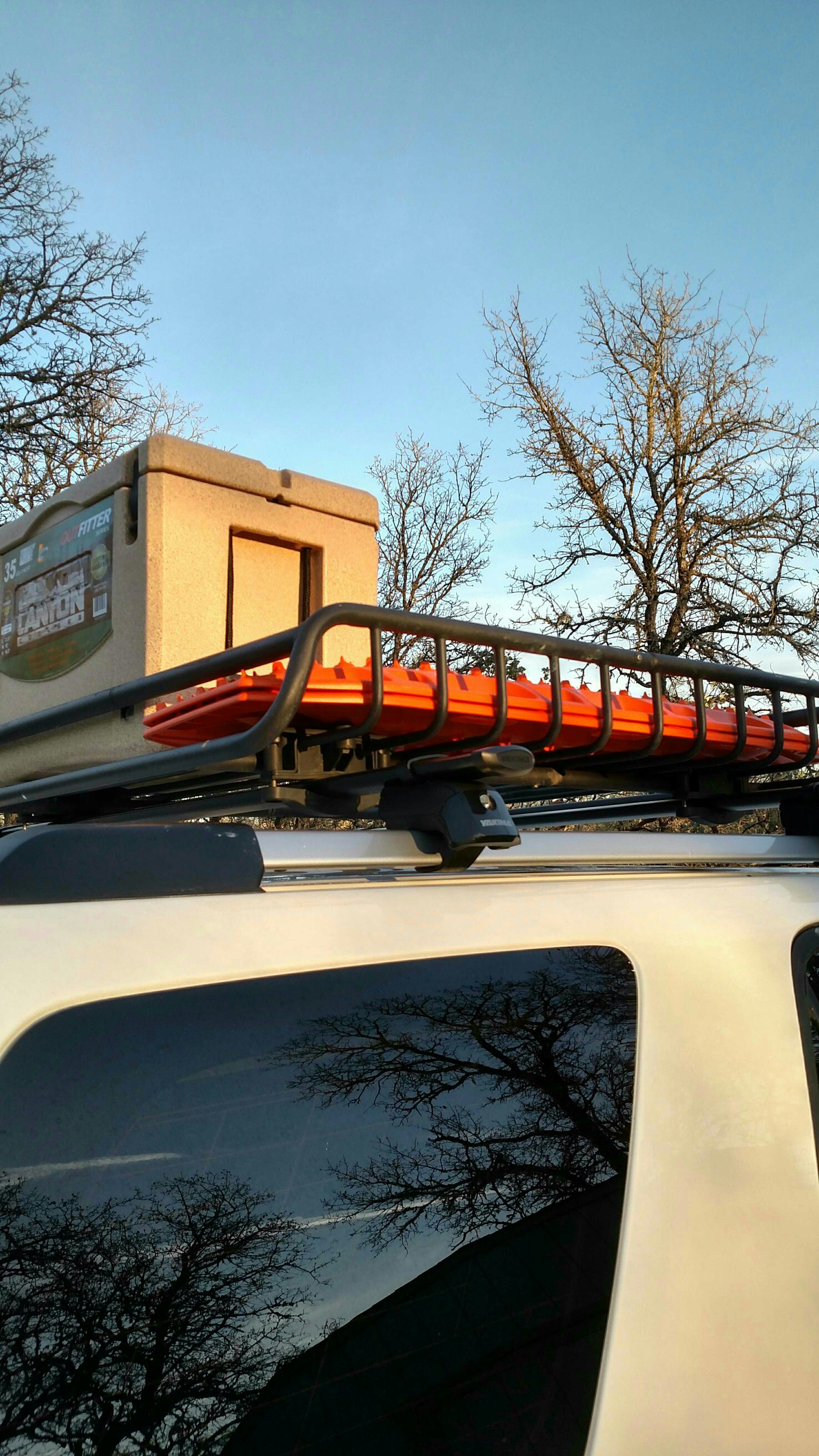

I had nuts welded to the underside of my rack bar so I could mount my traction mats with bolts through direct to the rack without taking rack space. They angle up against the rack side bars and are held tight to the tie down bars so there is no flap or play there. I can just run a combo cable thru the hand holes to the rack rail for security.
