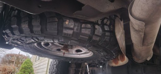

Picture proof that a 35" tire fits the Superduties OEM spare spot.
'nother reason the 10.5 width seemed like a better idea than a matching 12.5, more ground clearance.

That's another reason I like to run the 285/75R18, you can fit them in factory spare location. Most measure 34.5-34.8" tall x 11.2" wide so the height of most 35's but hits the in between of a 12.5 and skinny 10.5. The draw back to that size is it's not real popular so not all brands make it.

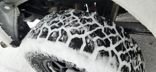

MidOH
Finally, some snow wheeling.
So far, these tires work fine. As you can see, they do pack up properly in fresh crunchy snow. And they do fling clear at speed.
My trucks completely empty today. So 2wd is meh, 4wd is awesome. I have no worries. Perfectly stable and reasonable.
Obviously the extra size provides more grip, until it doesn't. I'll air down to 35/30 for local trips.

Kenda Klever Mt2.
35x10.5r17.
Keeping that for my spare on the oem wheel. Trucks on 35x12.5r18. But that's too wide for my spare wheel.
Went with the Mt2 for a spare, because the RT in that size, isn't E rated.
Should be a good pizza cutter for Jeeps and such.
I think I am going to run those 35/10.5/17 if I can buy them locally. That's a goldilocks tire size. no need for huge width here, but height is needed for rocky trails. I wish more companies made this size.
