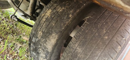

Even with solid front axles? A friend of mine ran a small fleet of 4x4 Ford tow, roll off and extraction trucks 350s on up to 550s and never was a problem, but that was a few years ago.
Oh yeah. Even solid axle trucks.
This inside rear, on my brand new Ram 3500, was on the right front. The front tires wear weird. Notice the inside edge wear and feathering.
All of our trucks and vans do this. The whole fleet.

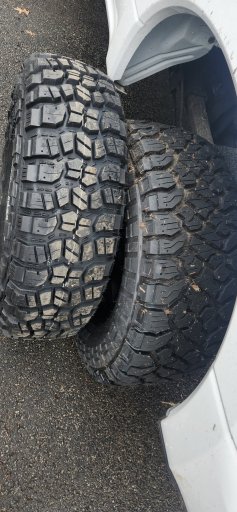

The more aggressive Kenda Klever RT:
Four 35x12.5r18, for $1155.

I'm going to find out. I do tons of gravel.
One of my old wheels will be getting a 35"x 10.5 r17 Kenda Mt2. So I'll have a 35" spare in the OEM f250 spot.
Put 295/85r17 on my previous truck. It struggled when the pumpkins dragged on frozen snow. The extra clearance of 35's is slightly overkill for this year's overlanding plans.
At this price, I'm not going to be too picky. If they last 35k, I'll be happy with them.
No wrinkles in the sidewalls or anything. Nice rim protector.

Kenda Klever Mt2.
35x10.5r17.
Keeping that for my spare on the oem wheel. Trucks on 35x12.5r18. But that's too wide for my spare wheel.
Went with the Mt2 for a spare, because the RT in that size, isn't E rated.
Should be a good pizza cutter for Jeeps and such.
