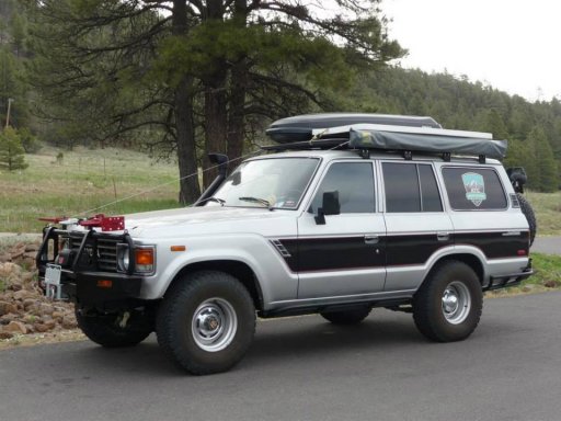

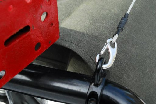

IMG_0558.JPG IMG_0322.JPG I've had on my 87 for years. They have come in handy when in the tight brush. The cable and clips are stainless steel and sourced from West Marine. The Clamps on the ARB were fabbed up from clamps used on shaft driven equipment. The only issue I've had was on real rough rocky trails when the frame twists it'll put a huge amount of tension on the cable, snapping the cable. Heavy springs would correct that issue. Good luck.
