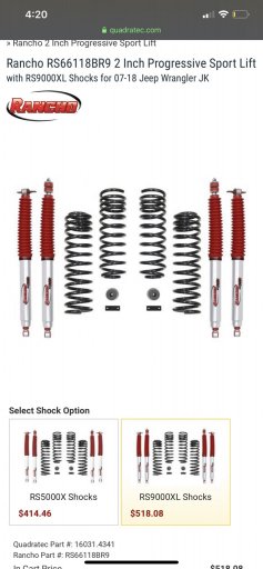

So i have a 2016 Jeep Wrangler sport 4dr and i has just put a set of falken wildpeak a/t tires on it 285/70/17. With a bigger tire then factory I’ve been window shopping 2”-2.5” lifts but me not knowing anything about lift kits idk what to look for or what is good or what is bad. Any help would be greatly appreciated. The picture attached is a kit from rancho I’m considering but not sure about View attachment 132589

I would talk to a reputable shop. What you are looking at there is at the lowest end of suspensions. If that is what you want to spend then fine. But with suspensions you get what you pay for big time! Look on YouTube you can learn alot!

What are you looking to get out of the lift? How do you use the Jeep (is it your daily driver too)? Are you currently having tire-rubbing issues? All of these are important questions. Luckily, or unluckily, you have probably THE most popular 4wd platform EVER. That's great because any part you could possibly imagine is available for it - but it's bad because it can lead to paralysis through analysis with all the options that are out there. With a little better idea how you use it we might have better suggestions. However, I will say at that price-point really "it's worth a try." You might find you don't like the ride as much and such, but at least you won't have a ton invested in it. I'd say 2-2.5" is the max I'd even consider before you get adjustable track bars and perhaps mid-arms.

Certified Mopar Tech here who does all the lift installs at our shop. Rancho is bottom of the line stuff. You WILL blow those shocks in a couple years.
I install more Mopar lift kits than anything else because since we are a dealer we offer a dealer warranty on parts and labor.
Teraflex and ICON Vehicle Dynamics will he top of the line.

The AEV stuff is good quality, and I believe they carry a warranty on their parts. They're running Bilstein shocks (supposedly with their own valving...) which have been a perennial favorite for a DD/weekend off-roader shock (I run them on my WJ and really like them). It's not that I'd say the AEV is "not as good" as Icon, Evo, etc. just that it's a different kit with different purposes in mind. I do like that the AEV kit appears to include at least one track bar. As @Seanm26 pointed out the Mopar lift is very popular, and if you have a dealer install it it doesn't impact your warranty (though, as a 2016 you are probably about at the end of the warranty anyway). The thing I don't like about the Mopar, the Rancho you listed, and other 2-2.5"s is that they don't include track bars. When you lift the Jeep the factory track bar will force the axle off to the side a bit (not a ton w/ a 2.5" lift... and obviously Jeep thinks it's acceptable for a dealer-installed lift) which could cause tire clearance and other issues. On top of that, the leverage is increased on the track bar, so a stronger unit with higher durometer and/or heims is a good way to avoid death-wobble and other problems. Heims/johnny joints/etc. will be noisier though, so that's something to consider if you go that route.

Agreed with what TJ said! Regardless of what lift you get I highly suggest getting an upgraded track bar if it does not come with one.
