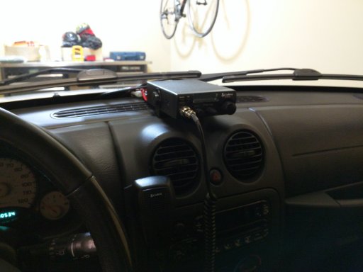

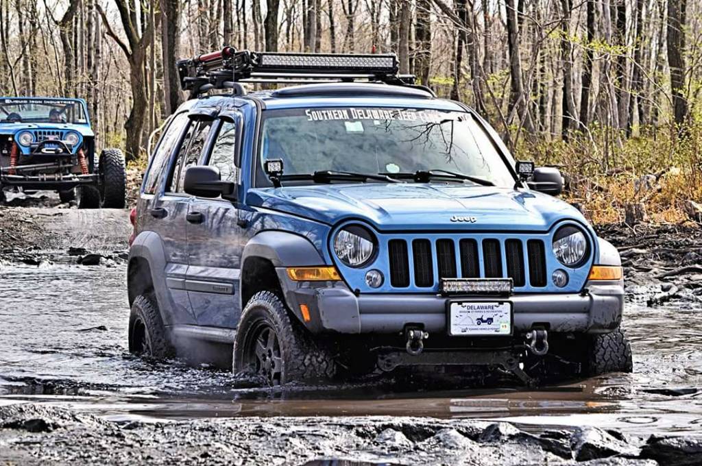

First thing was A CB and A light bar (Past Me, you were an idiot for this one.)
Here I am doing a little shakedown run in the Pine Barrens. (Why did i put the light bar there? WHY?)

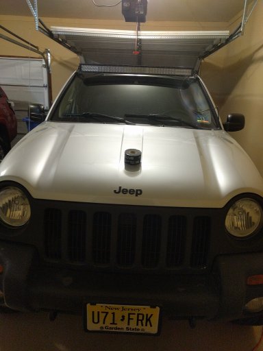

Later on, I finally fixed my idiotic light bar placement. Using some chevy silverado brackets modified to work with a 42" curved light bar, I arrived at this:
Much better!.

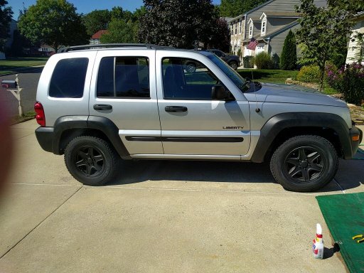

From there, I got a new set of tires the next year, after I lifted the jeep using a budget spacer lift.
She is now on Dick Cepek Extreme country 31"s.
You may notice I had to trim the front bumper for clearance.

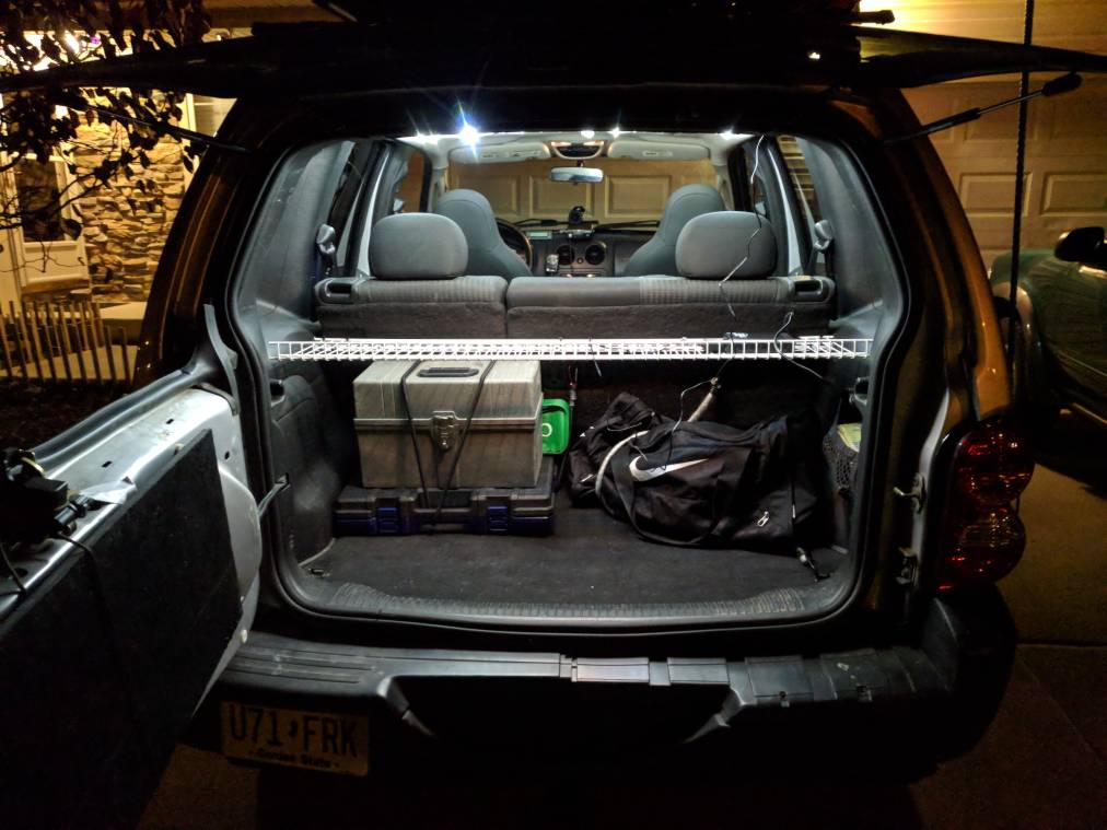

Now we are basically caught up to current day, yesterday I built a rack to enhance my very limited storage in the rear.

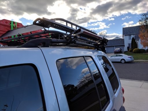

Finally got a roof rack! I bought A Curt roof rack on Amazon, as well as Apex Rage Crossbars on Amazon.
I then put my knockoff maxtrax up on the rack with some cargo straps until I figure out a better mount.

Soi installed some LED lighting to make up for the disgustingly poor lighting the stock lights provide.
They are powered off of an inverter + power brick right now but I plan on wiring them into the 12v port with a switch.

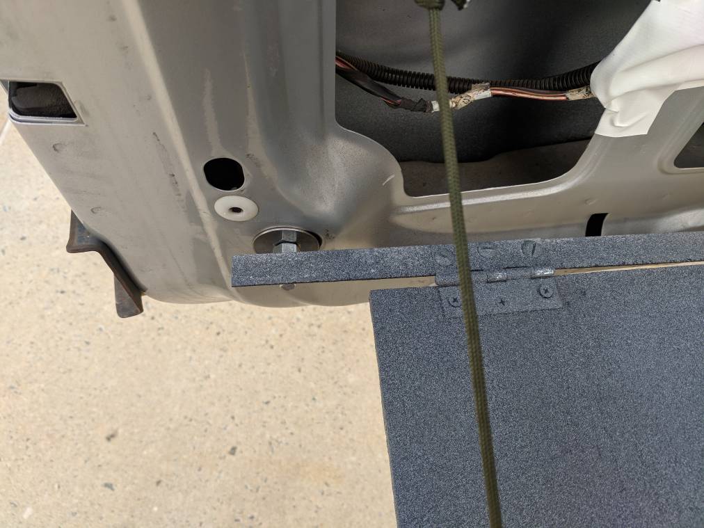

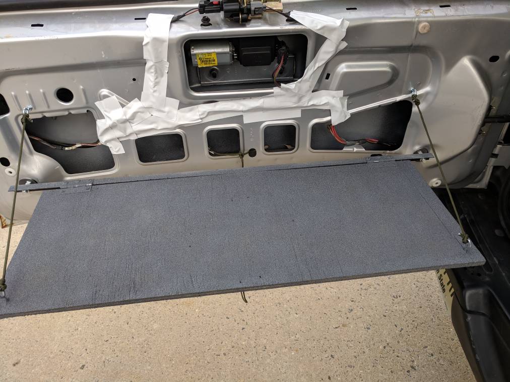

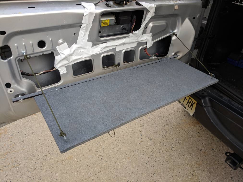

Oh yeah, I also built this:
As you can see I have all of the wiring taped up until I get a proper backing material.
I had to put studs into my tailgate to attach a flat aluminum angle because the tailgate is not flat.
I will be replacing the Paracord with steel cable soon, but I was too excited to get the shelf up to wait.

Got my Hi Lift mounted up on the rack now. I previously made some mounts that integrated into the spare tire carrier, but I wasn't really thrilled with the location.
I was able to re-purpose those brackets (just some galvanized steel strips) and attach them with u-bolts to the crossbar. It is super solid.
You may notice my ghetto handle holder, im too cheap to buy a $12 plastic one, so gorilla tape works for now!
