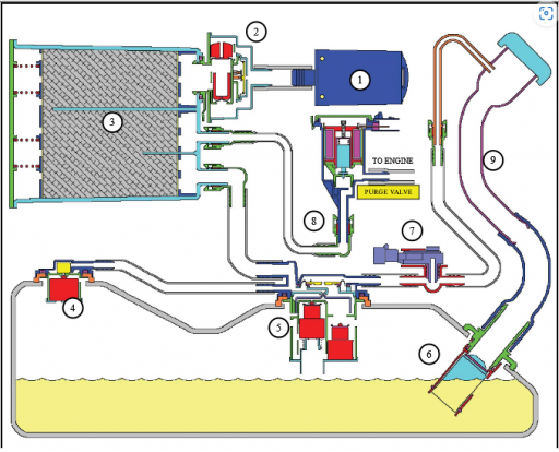

First off, what is the EVAP system. The EVAP system captures fuel vapor instead of letting the fuel vapors escape into the atmosphere. The vapor is captured in a sort of Ghostbuster's containment unit called the "EVAP canister" or "charcoal canister". Eventually, the canister collects enough vapor that it needs to be purged, at this point, some valves are moved around automagically by the PCM, and the vapor is shipped to the engine to be burned off.
Here's a picture i found of a typical evap system. look at it. wow. so cool. ... wait, is that urine in the gas tank?
The primary pieces relevant to my journey so far are:
2) Leak Detector Pump / Evap Valve (normally open)
3) Evap canister
8) Purge Valve / Purge Solenoid (normally closed)
Uncredited Performance) Fuel filler cap (normally closed)
These are kind of the heart and soul of the evap system. When the canister (3) needs to be purged, the purge valve (8) and the evap valve (2) are both opened to create a drinking straw where the engine vacuum sucks the vapors from the canister through the purge valve into the engine's intake manifold, and the open evap valve on the other end allows clean fresh air to be pulled through the canister to replace the icky vapors. if any part of this straw is not working, things go bad. I should also note that this "straw" is sometimes closed on both ends by the PCM to either create a vacuum or to pressurize the tank, and again, if any valves are not working properly, this can lead to leaks. All modern gas engines also have leak detection capability. If any part of this system is unhealthy, you're likely to get poor engine performance, and eventually error codes and a check engine light.

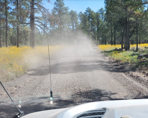

Next up was driving back from Overland Expo in Sept 2021. This is when i believe, in hind sight, that my major evap issues really started up. I started noticing while driving from Flag back down to Tucson that whenever my RPMs would increase past about 2500 RPM that there was a momentary stutter and lag in the engine. It happened probably 25% of the time my RPMs went past 2500 or so. The trip up to Flag had been our traditional "Expo the hard way" with the Herd of Turtles where we drive about 160 miles of dirt from Phoenix to Flagstaff to get to expo. I remember it being a much dustier trip than typical, so we were basically driving in a non-stop haboob for three days.
It was literally this for 160 miles, the wild flowers were amazing at least:

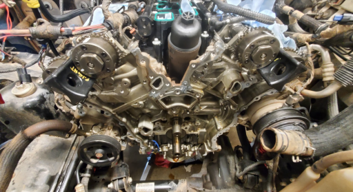

To complicate the matter, around this same time, I started having some issues with my MAF sensor and my cam position sensor. my MAF was super dirty so i cleaned that out solving that problem. The cam position sensor took a bit longer to investigate and troubleshoot. Have you ever taken your 3.6L Pentastar apart like 4 or 5 times? Yeah, me too, super fun! Eventually I discovered that my timing chain had stretched nearly a half-link, so I had the joy of nearly completely taking apart my engine and learning how to replace the timing kit. baptism by fire. I think I'm now officially a YouTube Certified Master Automotive Mechanic though, which is awesome.
Ok, anyway, back to the story. After the timing issue was all sorted, the evap issue was still a thorn in my side. For nearly two years now i had been tracking this issue down and bashing my head against a wall trying to figure it out with my very limited mechanic experience. It started as a grain of sand in my shoe, and by now it was starting to become a sharp piece of glass in my shoe. I was starting to note down symptoms and desperately searching Google for anybody having a similar problem. For future people googling, here's some food for the search engine so that they may find this thread and maybe find a solution to their problem, too.

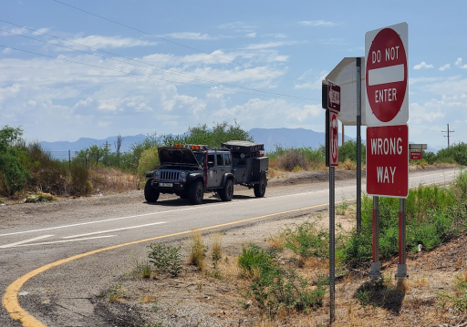

The stress test I put it through started off great. I put it through the worst case scenario, on the way to the trail there was a ton of stop and go traffic, lots of idling, yadda yadda. It took us about two hours of putzing through town/traffic to get to the trailhead, i left it idling on the trail as i got out and signed in to state trust land, walked around for a few minutes, then got back in the jeep and started up the trail. We made it about two miles down trail before it stalled out
This time was different though, or at least, i noticed something new, so maybe it was happening on previous stalls as well. When I got out of the jeep the surroundings were quiet enough that I could immediately hear the tank(s) bubbling.
Could that be vapor lock? I thought that was not a thing for fuel injection. I did touch the tops of the tanks and the hoses underneath and nothing seemed more than just kinda warm. When i opened the filler cap, a little bit of pressure was released, but not a lot.
