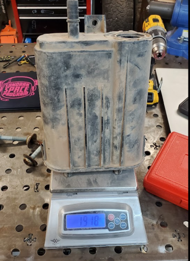

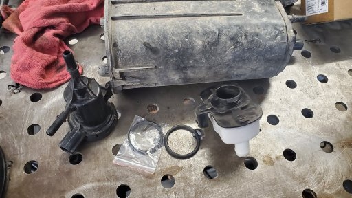

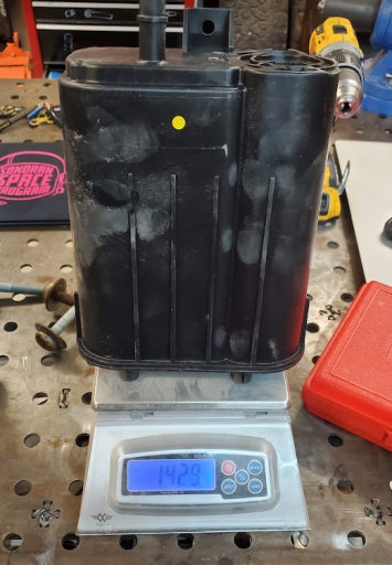

The parts all arrived yesterday and last night I went about replacing what I considered to be the major parts of the system the purge valve first, as soon as i took off the old one i bench tested it and it was fine. My heart sunk a little bit, while firing off the parts cannon I hoped to find at least one part that was definitely bad otherwise i would definitely be back at square one. One part down, two to go. I quickly popped off the leak detector / evap valve next and upon a quick inspection it looked to be in working order, although definitely very dusty. Dang, two parts down, one to go. I removed the one nut holding the canister in place, and as soon as I pulled it off, i could immediately tell it was considerably heavier than the new canister. Is this my smoking gun? only time will tell.
I wanted to confirm that it was indeed heavier, so i tossed both the old and the new on a scale I have in my shop and found quite a difference.
about 1.5 kilo for the new canister
nearly 2 kilos for the old canister! whoa, that's 30% heavier than the new one! Peeking into the hole where the evap vent connects, the filter inside was noticeably dirtier, obviously, and it looked like it was probably dust. Before I ordered the parts cannon ammo, I did some googling for symptoms of a clogged canister and it was all the same symptoms I had been seeing, and all the same symptoms that had been getting worse and worse. Rough idle, long start, poor engine performance, sh*t gas mileage (i mean, i get terrible mileage regardless, but it did seem even more sh*t than usual in the last year or so)

There was another new mystery a couple of days later. I started the jeep up in the morning to head to my shop and immediately got a "GASCAP" warning on the dash and the small evap leak codes. my heart sunk and then a couple of days later while tidying up the parts i swapped out i noticed something...
Why the hell are there two o-rings? I popped off the leak detector valve and realized i forgot to put the new o-ring on, doh!
after swapping that in and clearing codes i got rid of the gascap warning and the small leak codes.
