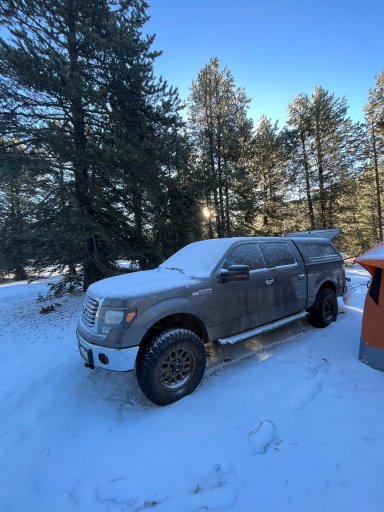

This is Feb 4 2024 above Fresno waiting for the big snow storm and it came fast and heavy. We had to grab our gear under the snow and head out on the 9 miles of snow covered back roads. This much snow in just 3 hours. This is our Visalia CA OB group trip.

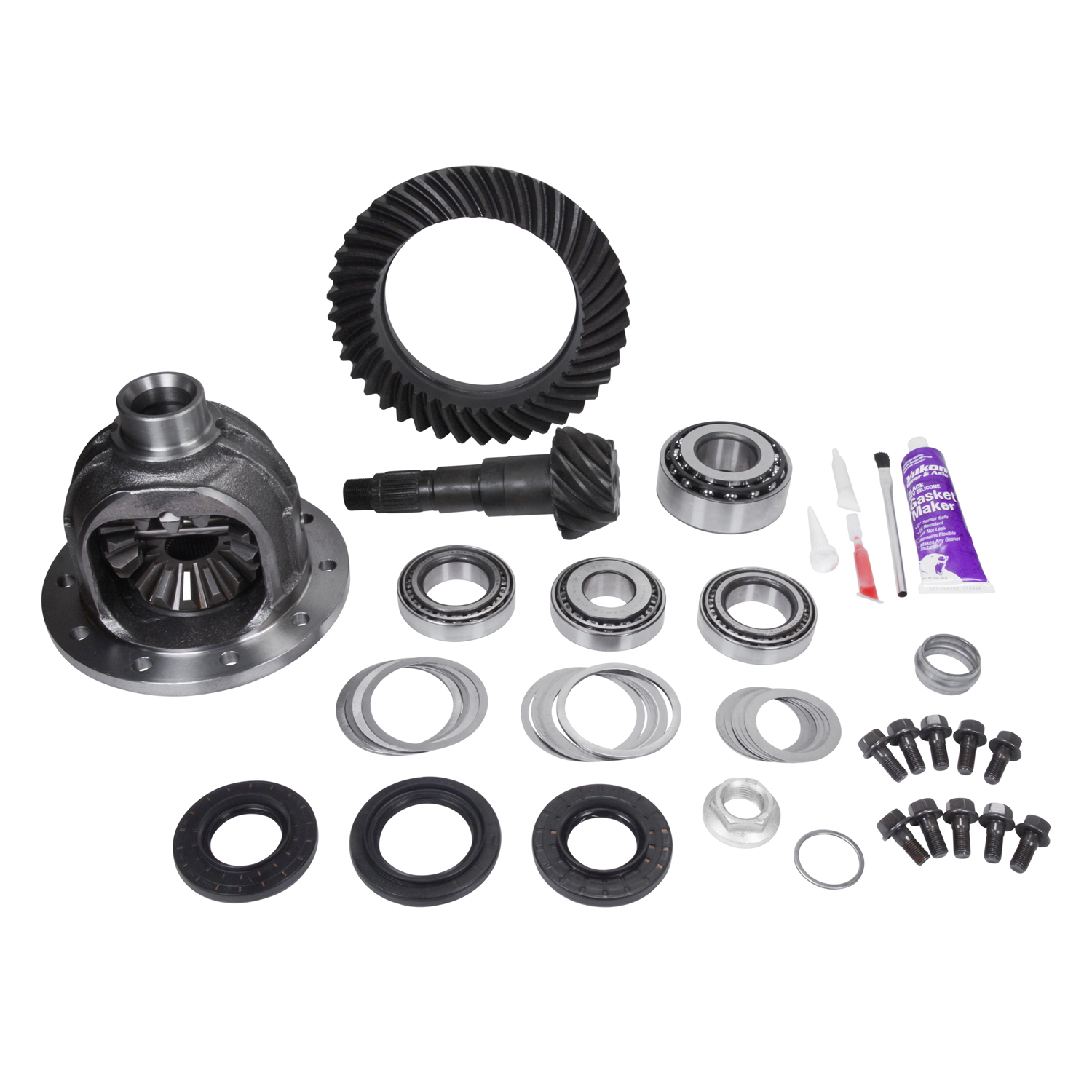

They make gears for the AAM Chrysler 8.25 IFS (aka ZF 215 IFS). You need a front end from an older Ram 1500 or a modified TrueTrac (the path I'm taking) to install them. 2019, they started using the problematic one-piece carrier/ring gear assembly. Per 3D scanning, the older 2012 to 2018 is the same IFS axle, but without the one-piece carrier. This will accept the gears that Yukon makes.
