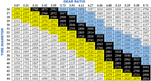

I'm not sure that I agree with you here. If the truck were a manual, or would remain a pavement princess, then sure, leave the 3:73 highway gears on. My truck is an automatic. I'll take all the mechanical advantage I can get. Using the tire size calculator here https://tiresize.com/calculator/
My Ram came with 265/70/17 which equals 31.6/10.4/17.
Lets round that to a 32" tire. My truck came with 3:73 gears from the factory. after going to 35s I was outside the optimal power ban, and I could feel it. Re-gearing to 4:11 is a no brainer to me as it puts me damn near back into the RPM range that the truck was designed to run at. Especially since I plan overlanding and running trails while I'm at it. Hell, I almost went to 4:56 gears, but decided I'd keep some fuel economy too.
