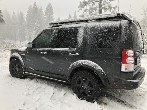

I haven’t done really anything for the height of the vehicle. I have suspension rods from Green Oval Experience in Australia that have three positions: stock, off road height and then “emergency mode” for lots of loft bit only for short distances to get you through the obstacle. I like them because they allow me to run stock height all the time then while I’m airing down pop them to off road height. Takes about 30 seconds a corner. Then I can use the computer to get more lift if I want.
I’m running the BFG KO2s at 265/65/18 and they are awesome. I’ve had BFGs on my trucks since 1996 and love them. The KOs are really good. I’ve got the KM3s on my 110 and they are amazing. IMG_4038.jpg

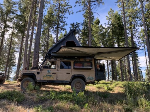

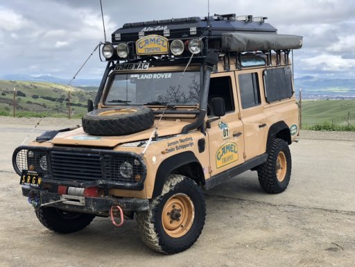

Not different types of trips, different number of people. The Camel Trophy is great for 2 people as the roof top tent isn’t that big. The LR4 is great when I take both kids or may dad who is in his 70’s. Both are very capable but in somewhat different ways.

Many of the BMW 18” rims will fit on LR3/4. Just have to get different wheel nuts. View attachment 108543
Is the back spacing the same or different. Are there more width sizes available. What advantage is there to use them, more cushion in the side walls ? LR4's have adjustable (computerized) air suspension don't they. You don't have need lift springs, right ? Is that something you have control over ? Very nice wheels and rig you have there. Cheers
Reactions: Shane Waters
Shane Waters
Alberta Canada
Shane
Waters
5254
Thanks!! Back spacing is just about identical. The reasons for 18s is the variate of sizes and they can be found at very low prices. I’m running 275 65 with just the 2.5” Johnson Rod lift. Ride is even better before now because of the increased tire sidewall. After the rods and tires are added you just need to have a wheel alignment to get everything straightened away again due to the lift.
