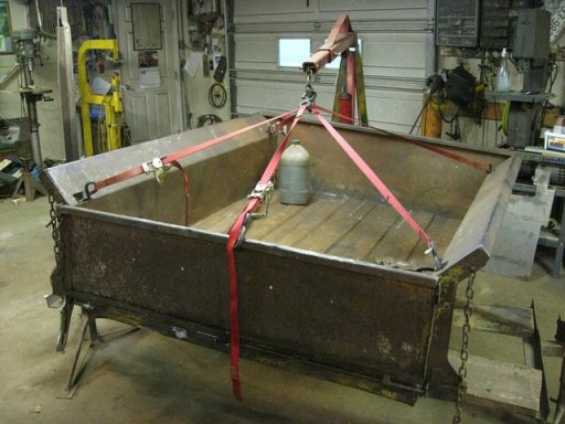

The original truck bed was not plywood and likely looked more like this:

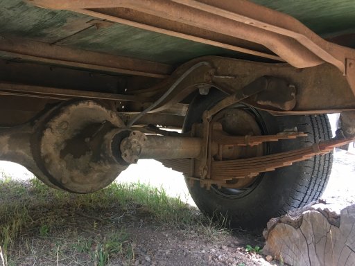

But anyways, I finally got to visit the trailer (I have it parked at a mountain property since my apartment is not as enthusiastic as I am about it).

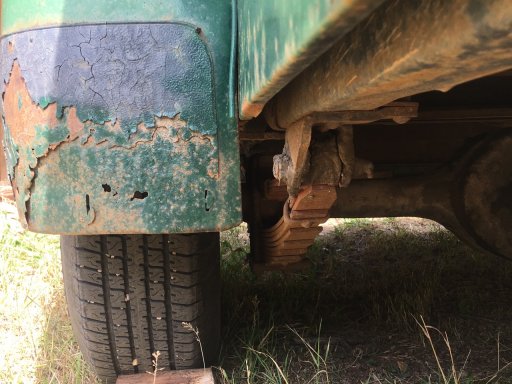

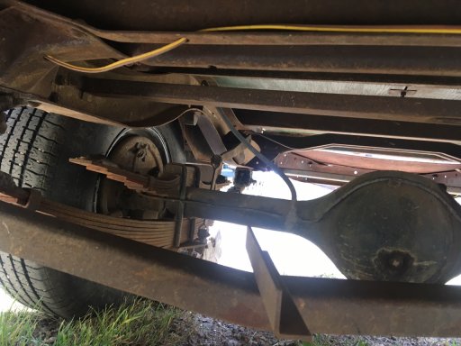

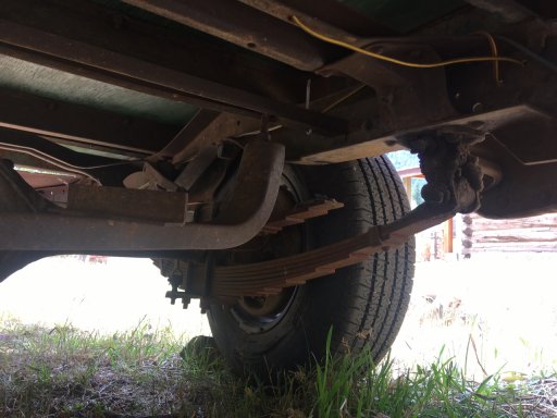

You guys seem to know your stuff, what can you tell me about this axle? Double leafs springs (haha). The leaf springs span 2/3s of the frame, which seems huge. The differential on this axle looks twice the size as my Jeep. I don’t know if that’s because it’s old or if it’s off something giant. It also looks like some axle component takes up the entire inside of the wheel. Is that a wheel bearing of some sort? What sense can you guys make of this thing?
Well it is a standard truck rear end, probably at least a 3/4 ton diff. The hydraulic brake drums are still attached and may even still have the brakes inside.
The bottom springs are the standard weight carrying springs and the top one's are overload springs that you can probably discard. It's as I suspected, the frame is the back half of a pickup truck as is the bed. Since the bed is steel it is probably late 50's or early 60's bed from a pick up truck. The rear end is not ford for sure and is passenger car type but could be 1/2 ton International P.U. It still has the very old 50's style shocks. It is a morphydite of parts. The frame could be a 1940's up type since it is C channel, and does resemble my 67 international. The bolt patter can tell you a lot. Ford, Jeep and International shared the 5 on 5" bolt pattern. If it's not that, then the rear could be Dodge or Chevrolet. It appears there might be a spare tire carrier behind the axle. Very definitely not a trailer frame, it's a modified truck frame. I see hydraulic brake lines still attached above the axle. I'm still thinking the whole thing is late 1950 - 1966 vintage because of the flared top to the bed sides and really resembles this Chevy truck bed. Conclusion ti all may be Chevy.
Should be easy to do a spring over axle swap on this but I'm not sure I would keep the rear end because of the weight. There is a way to put floating axle hubs on the existing axle and gut the diff-axles all together making it a lot lighter. Circle track Race car guys put them on their front hubs for safety.

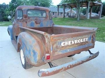

This is another box, very similar also. Not sure what it is, could be a 50's model Ford or Chevy
Reactions: MtnManAlex

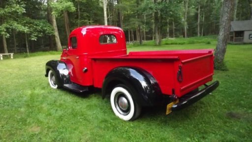

It’s definitely a Knox bed. It has “Knox” stamped into the gate. It is nearly identical to the 1948 International KB2 3/4 ton (pictured below).
So the frame is a modified truck frame? Do the frame and box match each other? If so then it’s probably an international 3/4 ton frame too. The internationals also came with 5/5.5 wheels.
Thanks for helping me figure this stuff out! If it is in fact 5x5.5 then I can find cheap wheel adapters and fit Jeep JK wheels on it.
As of now, I probably won’t bother modifying the axle or suspension too much. Thanks for pointing out that the “double” leaf springs are on purpose. I really thought that was just thrown together poorly.

5 on 5.5 were 1/2 ton wheels..3/4 ton have 6 on 7.5 ? wheels. If they used the international box I don't see why they wouldn't use the frame too.
Those fenders definitely look more like the ones on yours but the box is probably a short bed judging from this picture the fenders are closer to the rear
of the box on your trailer. At least as well as I can see from your pictures. If you'll notice the tail gate on this red truck does not have a name stamped into the sheet metal. There is a good chance the tailgate is International with Knox stamped on it. Internationals were a better built truck than the rest because of their use on farms. It's possible that international was the first in the 40's to make a steel bed and is why Knox used them.
Boy this red International is a beauty. My dad had the delivery truck version (panel truck) of this red truck that I wrecked back in 1948 when I got T boned by a new 1948 Pontiac club coupe. Smashed his grill clear up to the windshield, only put a large dent in the body of dads truck. Didn't even bend the frame. Dad continued to drive it but it was ugly...and I left home after that. I was 13 years old.
