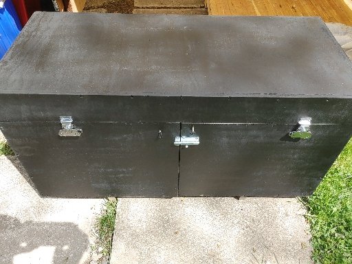

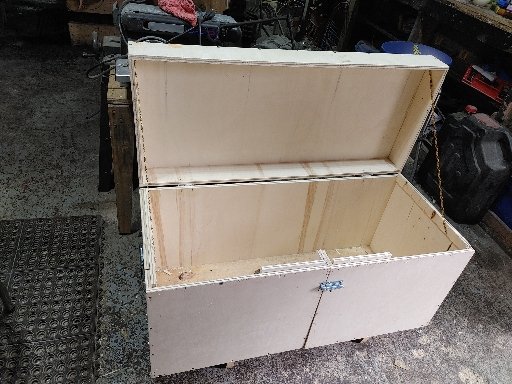

What I am showing is the dyi camp kitchen box. Prior to a kitchen box, compact kitchen gear was crammed into a 30litre pack barrel which was part of the canoe gear.

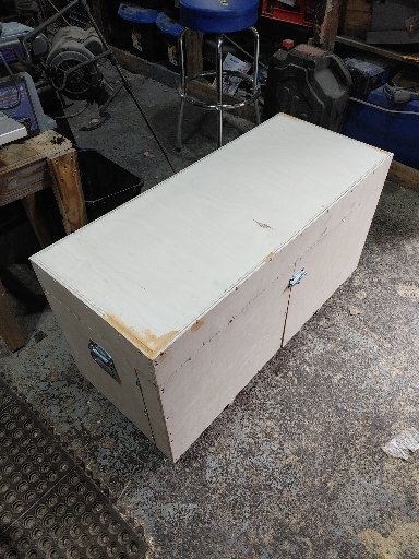

The kitchen box itself was built just as a plywood box, glued and nailed. The first cut on the table saw was the 3" lid. With the lid was removed and the top side open I ran the box through the table saw cutting 3 sides removing the front, then the front was ripped in half.

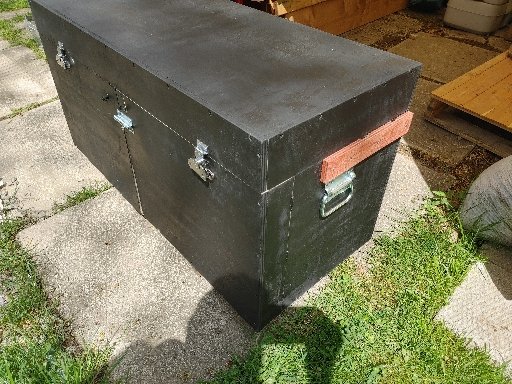

The hinges, handles and locking devices were then added. Firring strips were added to somewhat weather proof and guide lid and doors into place.
Measurements were garnered from needs.
Only one 4' x 8' sheet of ½" plywood was used.

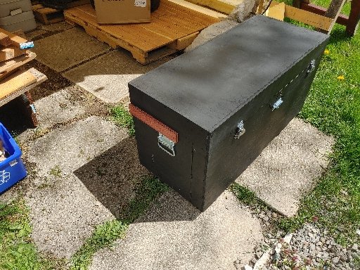

The outside dimensions matched the space available just inside at the rear of the truck and fit perfectly on the tailgate when opened up.

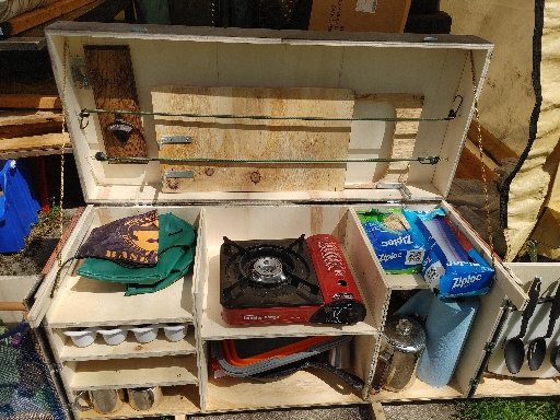

When opened, collapsible basin and cook surface.
For less then 150.00 we have our kitchen Chuck box.
The box was painted black and is just awaiting aluminum 1" angle to trim it out.
Looking forward to our first expedition this spring.

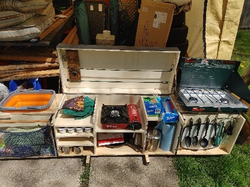

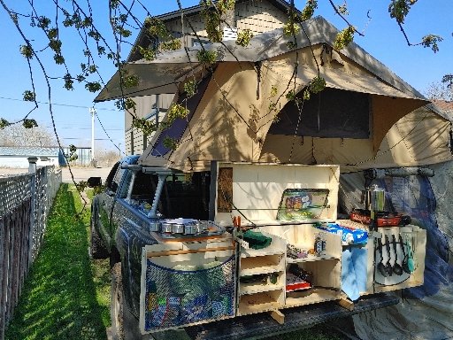

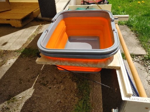

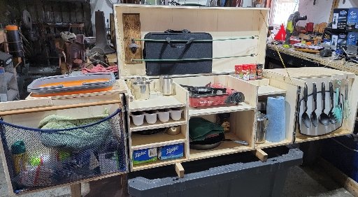

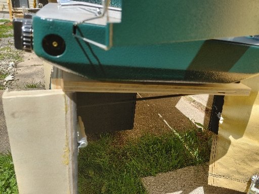

All set up... Side tables are held firm with L-brackets and Bungie cords... Collapsible sink cut out in one side board.

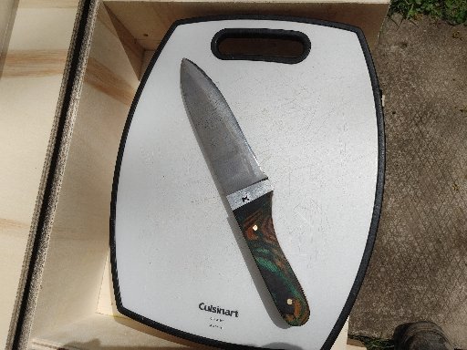

Needed a chef knife so I hand forged it.
