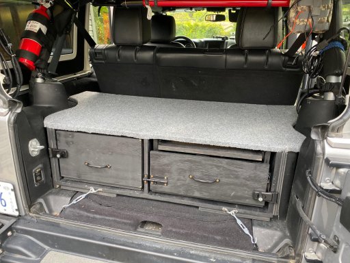

Just to update everyone. In the end I ended up going with Falcon 3.3 shocks ( I was able to find for sale new in opened box locally at 50% off retail) and paired the shocks with Teraflex outback spring set ( TeraFlex - JK 2-Door 3" Lift – JKU 4-Door 2.5” Lift: Outback Rear Coil Springs - Pair)
I recently took the jeep out to the Rendezvous in the Ozarks which is a 650 mile drive from Chicago. I just have to say that I simply couldn't be happier with the suspension set up. I added even more weight to the rig with the addition of a DYI drawer system in the rear and the jeep drove phenomenally both loaded up and empty. The rig just feels more planted and stable. I highly recommend the set up.
