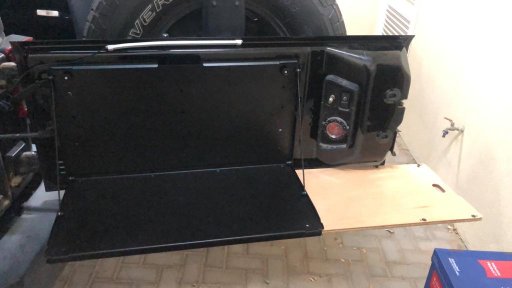

I fitted my Front Runner Tailgate Table yesterday; but as mentioned above the nuts supplied are not great and i actually lost 2 into the tailgate when fitting! The table is currently attached throguh just 2 points.
I already have the 10mm holes in the tailgate and was wondering if anyone has any good ideas for what mounting hardware to use in place of the 2 lost run nuts?
