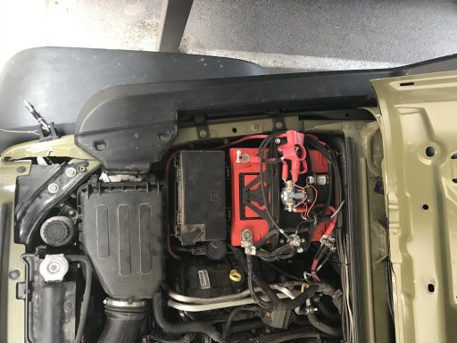

4B04AE63-D60E-4F63-A012-FFA9AB448F20.jpeg F9A39D39-9E9B-455B-B976-4DC68AF28082.jpeg I love overland bound but I have to say thank god something finally about Jeeps bought in April 2017 added 2.5” teraflex lift, smittybilt rack, tuffstuff front winch plate,+ 10,500 lb winch,lights,cb, rear drawers (diy) and waiting for wife’s tires to wear down(in the background) so I can swap out stock tires for 285’s. Along with a few more upgrades . I’m about 75% done with build but does it honestly ever end , I think not . Thank you for starting this post !!! Let’s see more fellow jeepers post their rigs
