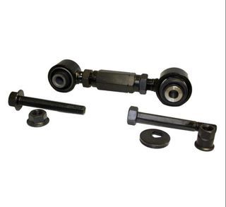

Thow link Oem Is extremly cheap ( and other part , i knows ) the difference with this part is adjustable and no more break , the parts will be able to work properly

any downside to the RRO kit. does it eat through ball joints or eat up cv shafts?
