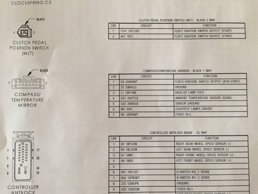

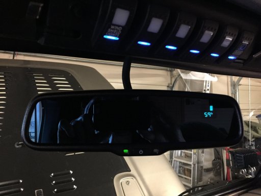

Installed a Gentex GENK20A auto-dim mirror with compass and temperature display. My ’04 came with the oem harnesses for the temp sensor and for the mirror. Installed a Mopar temp sensor into the oem socket located just behind the grill. After scouring the interwebs for an oe mirror wire jumper harness without luck, I snipped the oe connector and spliced on female bullet connectors to the wires (minus the mirror map light power & gnd wires...future possibilities?). The Gentex came with a power & gnd wires plus its own temperature sensor & wire bundle. Their terminals fit/clicked into the mirror’s connector so I cut an appropriate length from the temp sensor wires and spliced on male bullets to plug into the Jeep’s harness. Procured a wire from an unused harness for the backup undim feature and boom...working mirror. Loomed the wires and tucked away this morning:
Making a bracket to securely mount the temp sensor behind the grill and this project will be complete.

The mirror (Amazon) came with everything needed to install in any vehicle. You’ll need to source your own wire for the reverse undim (back-up lamp feed) option (only req’d during darkness to be able to see while backing up, if using the mirror). The “kit” didn’t come with instructions. The GENK20A 7pin-out is ( power/gnd/backup/?/?/temp sig/temp gnd ). The ? might be ( map light pwr-constant/gnd ) or ( side mirror something/side mirror something ). The TJ’s compass/temperature mirror connector 7pin-out is as follows:
The GENK20A’s pins I’m using are the first three and last two: (ign pwr/gnd/backup/empty/empty/temp sig/temp gnd) And they are connected with the first five of the TJ’s oem pin-outs (the courtesy lamp and fused B covered in elec tape).
