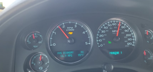

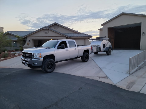

If I was going full-time and doing lots of miles and needed good range and MPG I'd use my HD to be honest. I recently moved out to Vegas, but I work in the Bay Area (CA) so I decided I wanted to keep my little trailer out here so I could do short weekend trips on the weekends I don't go back home to Vegas. For the long, high-heat drive from Vegas back to the Bay I decided to use my pickup instead of my WJ:
Here are the MPGs doing 70+ nearly the whole way:
My speedo is properly calibrated so the speed and MPG are pretty close to accurate any time I've checked against GPS and hand-calculated mileage. No, it's not going to do what a Gladiator does, not at all. But for *most* it's probably enough, and with the 60 gallon replacement tank underneath, and a 65 gallon tank in the bed at this MPG I have an over 2k mile range.
Anyway, sorry that was way off topic. But, the point was if MPG is a major consideration (as well as range) a Gladiator probably isn't the right choice. However, the Gladiator has TONS of upsides that I'm sure the OP enjoys, they just have to pay for it at the pump.

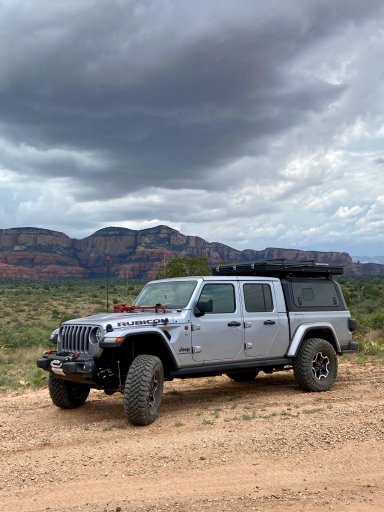

You've built an awesome, but heavy and even less aerodynamic than stock rig. It's not going to get stock MPG. The best suggestion is to just slow down a bit, 80 MPH is a LOT pushing that thing through the wind. Of course, I'm realistic and know slowing down isn't for everybody, especially when you get out of CA and there are no towing speed limits so Big Rigs breath down your neck if you're not doing 80.
So I have to ask, is this:
really the case? You have a '21 Gladiator with tens of thousands of dollars of mods into it, is a couple more bucks for fuel really a big deal? Let's say you do re-gear or do other things looking for MPG, how many miles will it take to recoup $2-3k re-gearing front and rear?

Agreed... did our best when building by keeping everything for the most part inside, contained and a low profile tent. All adds up nonetheless.
Nice. We just got one of the Rubicon Gladiators as a rental after my girlfriends GMC Terrain had to go into the shop for bodywork.
Cool Treep. Juck. Whatever we want to call it. They should have called it the Scrambler, since that's its lineage, but anyway...yours looks good! I like the truck cap.
Big knobby tires? Horrible for fuel economy. I feel confident that something like the Michelin LTX A/T in a similar size would allow you better highway manners, less road noise, better fuel economy. I dont know if they can handle the rough stuff as well, but certainly something I'm looking into. As we ride in this Rubicon rental. The hum and vibration is tiring. Tire-ing... See what I did there?
As was mentioned, these things are bricks, but they are smooth bricks. Everything you put in the way of airflow will cause a spoil. RTT has already been mentioned.
The Hi-Lift jack (previously just known as a "jack" in the era of the Chrysler Cordoba and Chevy Impalas, around the time "Grease" was in the theaters) being right in the craw of your hood/windshield is surely not helping. It may not be the worst offender, but it is part of the issue. I see them on Jeep hoods all the time. To each thier own. But to me, it disrupts airflow and is exposed to weather. That's not the type of jack i want to try and use when its crusty and rusty from the rain. Others may have a different opinion and I respect that. They have experience with it. I never put a jack exposed.

OK, shes' a big , heavy girl with lots of junk in the trunk... she performed flawlessly and is just a little thirsty; to be expected. The analogy of putting a brick on top of another brick after raising it and putting bigger tires and then putting the coals to her to get to our destinations... I respectfully withdraw my dumb question :) I guess the additional tank of fuel isn't going to break the bank. LOL. Thanks everyone for your well articulated and thought out responses... and the kick in the A$$. :sunglasses:
