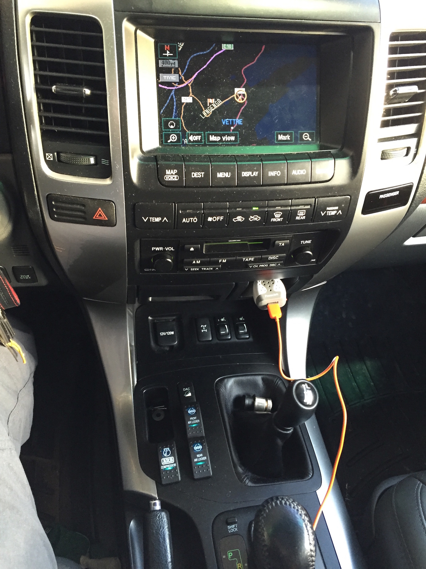

But took some with my phone filling up the tank this morning. Seems like Gas stations are our second home...
The Prado has now got a African Outback roofrack, repainted from grey to black, to match the Prado. I´m really happy so far, altough it´s only a week old, so I´ll post pros and cons after more use. But for now it works well. Lots of anchor points. Minimal wind noise. And extremely solid and stable, when walking on top.
