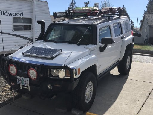

We have a Hummer H3 and use a single agm starter battery to run a 45 quart Alpicool $320 Amazon frig while we are driving. I replaced the fake plastic hood vent with diamond plate and mounted a 30 watt solar panel permanently to it and wired a small controller to the battery. When we are stopping when driving during the day the hood solar panel will keep up with the frig draw no problem. When camped we use a 60 watt folding Overland Solar panel that plugs into the starter battery to be able to follow the sun before it goes down. At night we switch to a Goal Zero Yeti 400 to run the frig till the sun comes up then switch back to the onboard battery. The Yeti 400 gets plugged into a 400 watt ac inverter to charge while we are driving during the da. I found that the dc 12v charging doesn’t charge fast enough while the truck is running so that’s why we do the ac inverter.D171041D-4122-4237-B6B4-978E2D7FEF1E.jpeg
