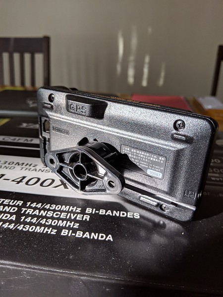

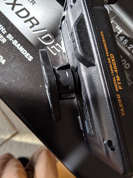

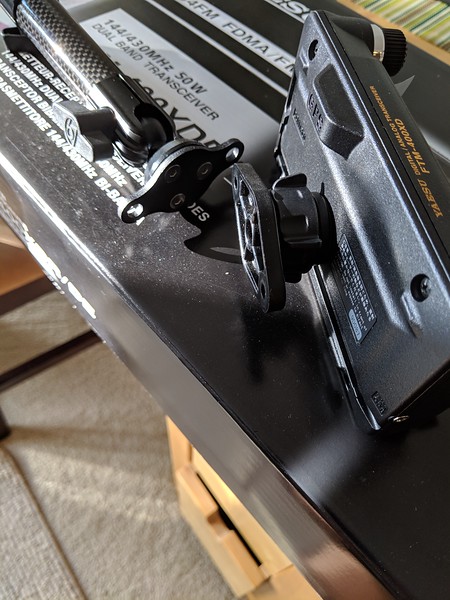

I've been gathering a few bits to setup my FTM400. I decided to switch from a Vector Offroad dock and ram mounts in the JK to the 67Designs mounting system.
I ordered a Lido mount for the FTM which I'm going to combine with a Ram Plastic Socket Cradle connector to simplify things a bit and reduce the number of "connectors" between the panel and the mounting arm, less chance for things to move around.
Ram connector:
I combined this with the socket, ring and screw from the lido mount which you can purchase here, Lido Yaesu FTM mount to achieve this:
It makes for a very compact mounting solution that will then be connected to the 67 Designs arm. This can also work with a standard Ram diamond mount.
This is the 67 Designs arm with their Diamond shaped mount attached:
I'm hoping to get it all installed this weekend although because I am going to order a shorter arm to position the panel just above the radio, I probably won't have pics until next week.

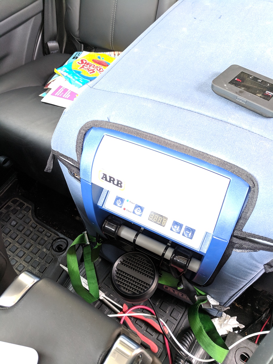

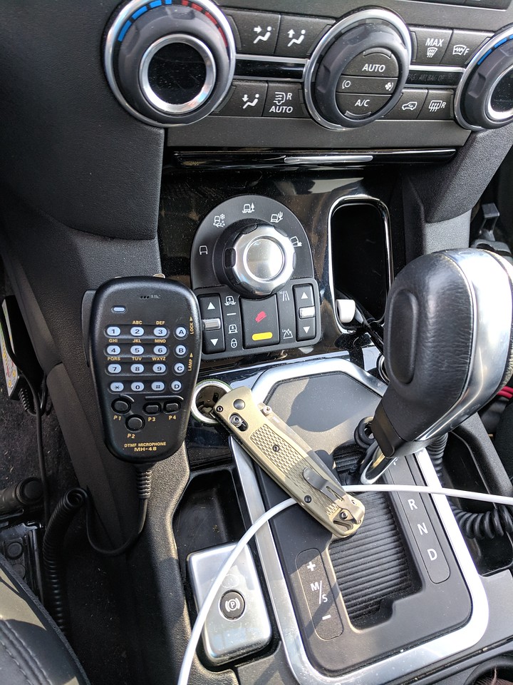

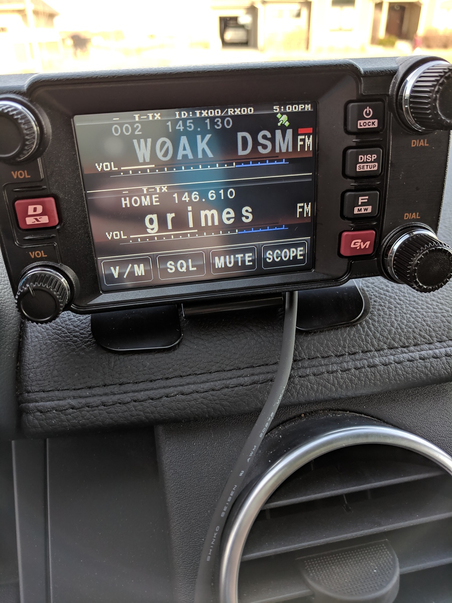

Go my radio installed today. Mounted the Comet SBB5 right on my ARB Summit bull bar. Perfect little antenna mount tabs on that thing. Comet 3D5M cable is about 16' and almost long enough. Had to mount the main unit under the driver seat. Got the coax through the firewall without too much pain.
Mounted the remote right on my dash with the included sticky thing. Hopefully that works. I bought an extended mic cable and also the external speaker. The speaker is amazing. The radio is crazy clear. i made a couple contacts on the local repeater and it was like having people in the rig with me! I mounted the speaker on the front of my fridge which is in my middle 2nd row. I can hear it well. I didn't have a good spot for it in the front of the cab.
Overall... love the setup. I've mostly just used handheld transceivers before, which is really limiting. Now I can make contacts all over the Des Moines metro without a second thought. It just works.

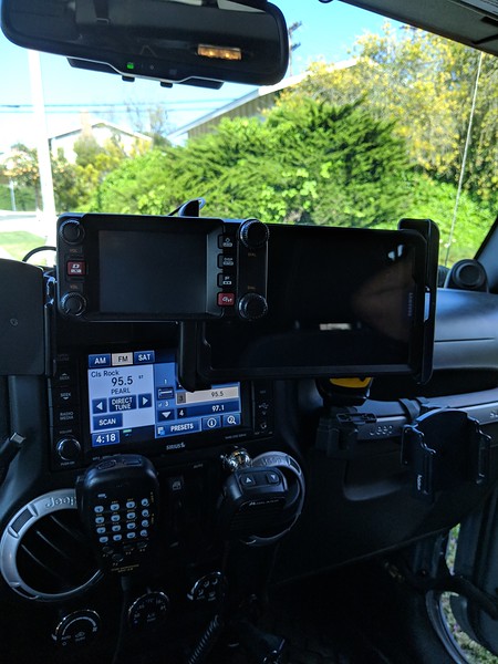

Here's my setup, although apologies for not the best pic. I bolted the ham chassis to the bottom of the seat which keeps it up out of the way. Head unit is on a 67 Designs JK mount, next to the tablet on the same. Inreach SE is behind the tablet on a JeepUniq mount, you can see the yellow case peaking through, which works because I don't really need any access to it once it's turned on. I'm using (2) Nite-ize Steelie magnetic mounts for the mics, one for the ham and one for the Midland MXT115. There is an additional mic holder on the InReach mount for when the CB is needed. I've go some cable management to do but otherwise it worked well on our last trip.
I'll get some better pics this weekend.
