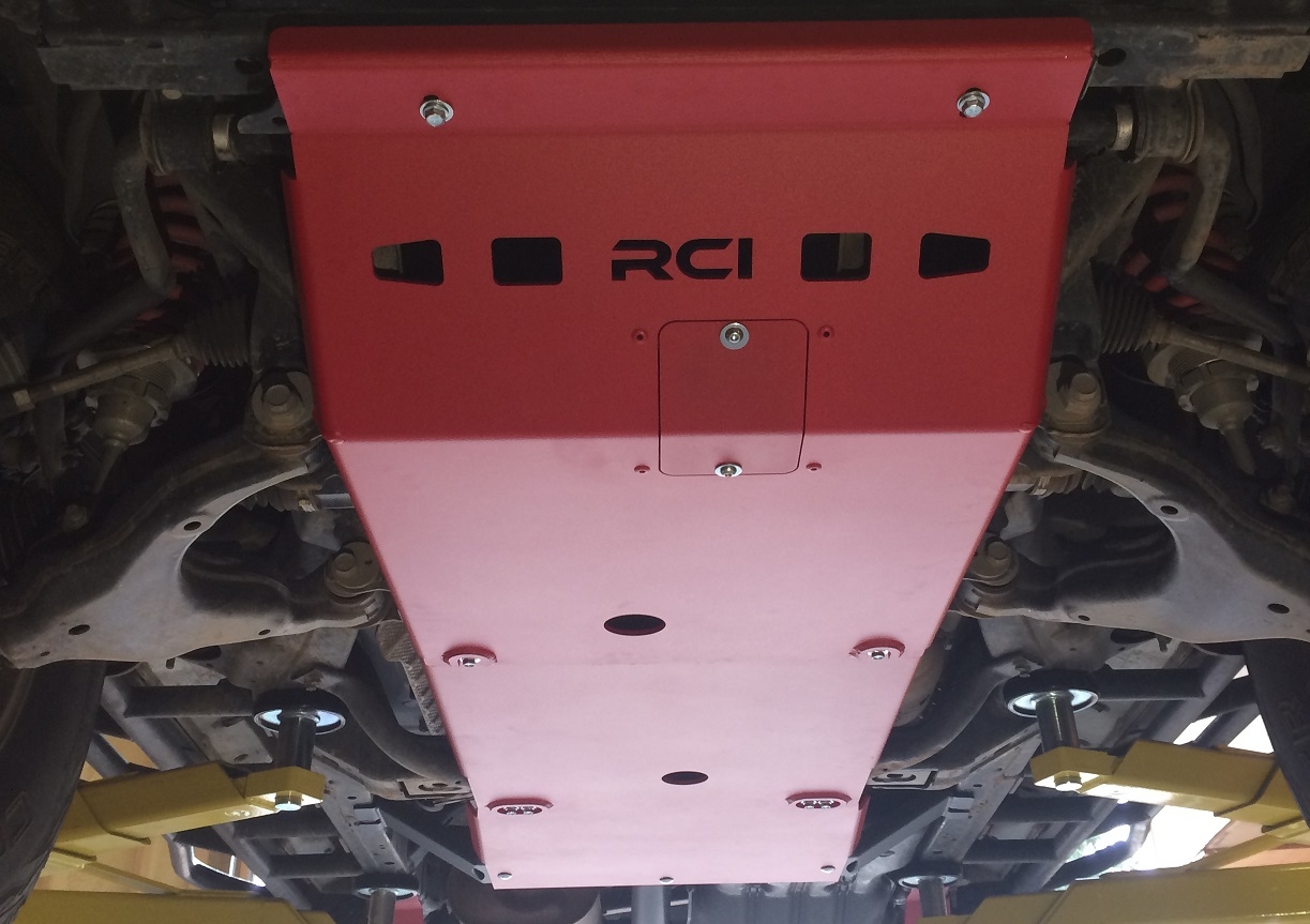

Thanks @codesertrat. I was on the RCI site last night and would like to have their full underside armor. Doesn't look like it comes up to replace that plastic silver piece that I keep hitting. For now, the RCI skid plates would simply be a much more robust version of the OEM Toyota skids.
Here is the RCI site photo for reference. So much cleaner and more protective than what I have. Might as well change my signature to MORE WEIGHT, LESS MONEY!

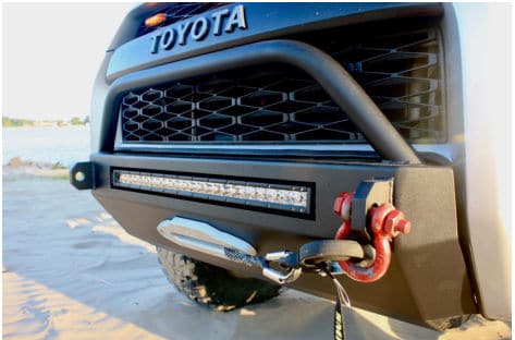

The protection you are looking for is called a prerunner bumper. The ones they make for the 5th gen typically replace the whole lower bumper however...
Here is a pic of one.
I don't think a company makes them, but you could probably find a fab shop to whip something up for you. Otherwise, I would go with a C4 fab bumper or something similar because they will probably be around the same price point and have the same protection in that area.

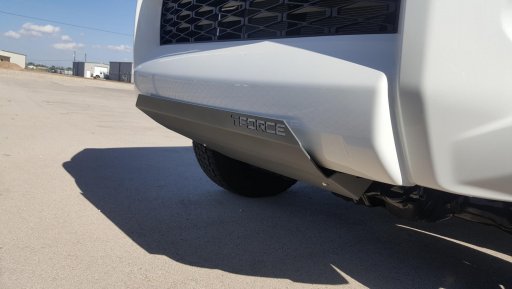

Excellent product. I got the second one they ever made. I like to claim to be the inspiration for that bumper because I didn't want to radically change the look of the new nose. As for the OP, see if your dealer has any contacts with a Gulf States dealership. They sell a Gulf States package called the T-Force that has a different front skid added that extends past the bottom of the front valence. Here is my bare bones SSO bumper right after the installation. And below that is a picture of the T-Force skid. I don't know if it will clear your silver bumper cover though because the T-Force package is added on a SR-5 4Runner, and they don't have that additional piece on them.DSC00484.JPGt-force skid.jpg
