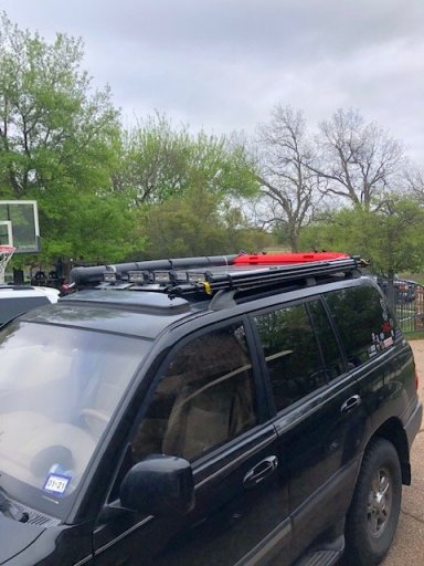

How are you guys carrying your recovery boards? I need to move my maxtrax from inside my truck to outside, and can't decide on either a roof rack mounting system? Or a the spare tire mount. I like the spare tire mount, and have a Wilco tire carrier, but not sure how secure they are that way, plus I will have my Trasharoo mounted on there, so not sure how much of a pain the butt would make it. Another option I am considering is running them at an angle across the front of my roof rack, so they kind of act like a fairing on my roof rack, using these clamps Recovery Board Mounting Clamps. I'm not sold on this yet, and not really sure how well these would last in a position like that.

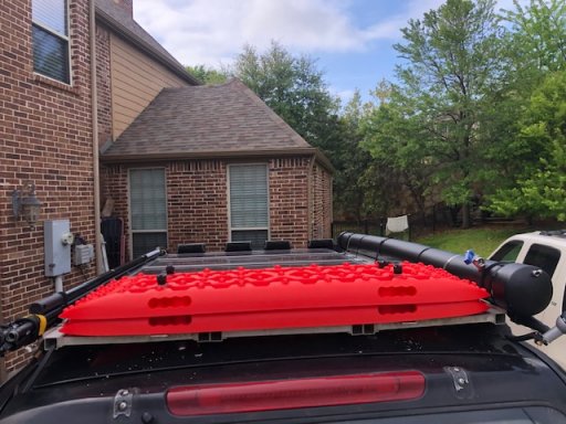

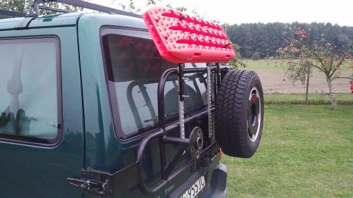

I'm not sure this will work on your rack, but this is a solution we came up with to mount ours up there.

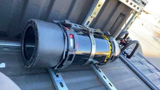

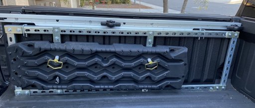

I made some racks of my own from channel strut, for both sides of the bed, to hold high lift, power tank, shovel etc. Its a work in progress...

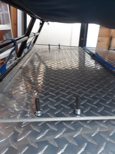

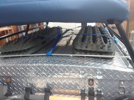

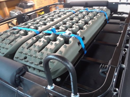

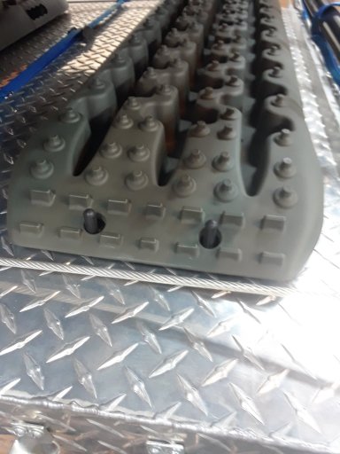

Either on the TJ's roof rack, or on top of the trailer's lid. The roof rack uses the same idea to keep in place - 1/4" bolts with vacuum caps.

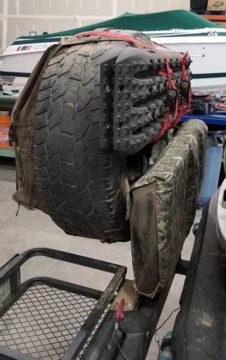

Here is how I dealt with it with my spare Wilco and a trasheroo. I just put two ratchet straps on them and a motorcycle locking cable.
You most likely know this but. I will say it for the benefit of those who do not know...
When a CO2 tank is mounted on it's side you need to remove it and stand it up right before you fill your tires. The reason is CO2 is a liquid when on it's side it is possible to push liquid CO2 into your lines and tires. In your air lines it can cause the lines to freeze and crack or even rupture. If you pump liquid CO2 into tires as the liquid turns to gas it will keep raising the tire pressure and may also cause the tire to rupture or even explode after you start driving down the road. As CO2 vaporizes and heats up the pressure can go into the thousands of pounds. If enough liquid was pumped into your tire this could ba a problem. Although this is not likely it is possible. I found out after filling my tires when the tank was mounted inside laying down the line cracked and started leaking fortunately I did not damage a tire. Mine is mounted standing up now.

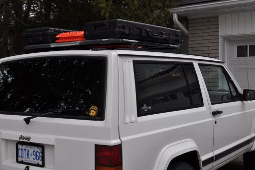

I'm currently building a rack for my Jeep XJ. It will be mainly for carrying 2 kayaks but when it's not it could be used for a couple of Pelican-like boxes with recovery boards in between. It was freezing out when I took this pic and I was in such a rush that I didn't even notice that I put one box on upside down. :grinning:

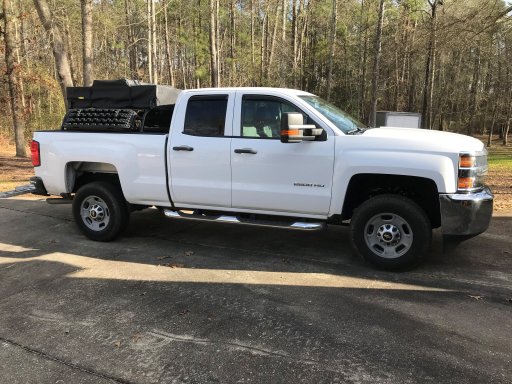

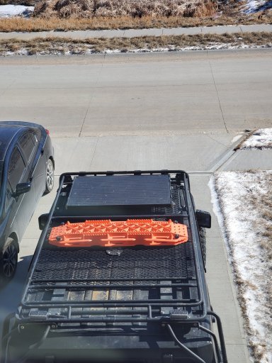

The rack on my truck is home made so I drilled a couple holes on the cross bar and put in a carriage bolt. Since my rack is shorter the boards kind of rest on the sidewall of the bed while being firmly mounted to the rack, less strain on the holding bolt. I drilled a small hole in one of the bolts on each side for a small lock to keep everything secured.
I don't keep the boards mounted all the time to help protect them from sun damage; day to day they ride in their carry bags in the bed of the truck. I figure once I use them and they are trashed I will mount them till I get home again to clean everything; then they will go back in their carry bags till next time.

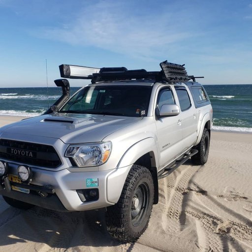

I keep them on my 14" Max Modular ALUMAX rack with Traction Board Brackets.

Are the boards only mounted at the top mounting points?
Yes, they are mounted at the top set of holes in the boards, and like I mentioned, since my rack is shorter, the bottom of the boards rest on the side of the truck bed. I haven't ridden anywhere with them mounted yet so no idea of wear and tear on the bolts or boards. Also as I mentioned, they will not ride there under normal day to day operation, until needed they will remain in their storage bags under the storage deck in the bed with the rest of my recovery gear.
