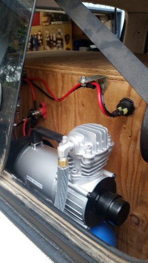

Another cruiser here running 4 gauge to the back. I've got a group 35 AGM in the RF corner of the truck. 4ga positive and negative welding cable goes through a boot on the the front wall, then into split corrugated loom, laying alongside the chassis harness along the RH sill. I have it popping up around the pivot of the RR seat and going to two terminal posts. My compressor and fuse block are wired to the terminal posts. Fridge power come out of the fuse block.
4 gauge going aft. Not shown is 50A breaker on the positive side. You can see a Blue Sea VSR under cables.
Plumbing it aft:
Buried next to OEM harness:
Popping up from carpet at RR seat:
Laying loose with storage box removed:
Fuse block mounted on side of box:
Wiring to 12V plug for fridge:
  • Love
