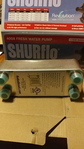

Its a project I'm working on.
The main components for my onboard hot water. Actually got the parts last year but got put on the backburner
Space is tight under hood with dual batteries, onboard air, etc. So, the heat exchanger will be tied into the rear auxiliary heater located underneath on the driver side of my Land Cruiser. Have not yet decided if I'm going to hardmount the pump or not but I will be using pressure washer quick connect fittings for the inlet and outlet water side. The pump is self priming and the plan is to have a good length of hose with a filter on the intake with a T fitting to accommodate some of the intake water bypassing the heater and running to a thermostatic mixing valve. Terminating in a shower head with an on/off switch.
