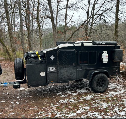

Any one else have any info on these trailers ? Going Saturday to look at having one built , any feed back is greatly appreciated. Thanks in advance!
I picked mine up on 9/1/23 and have about 45 days & 4,000 miles on it. I got a 5x10 Mid-Range XL with a rooftop a/c & Fridge box. I love mine!
