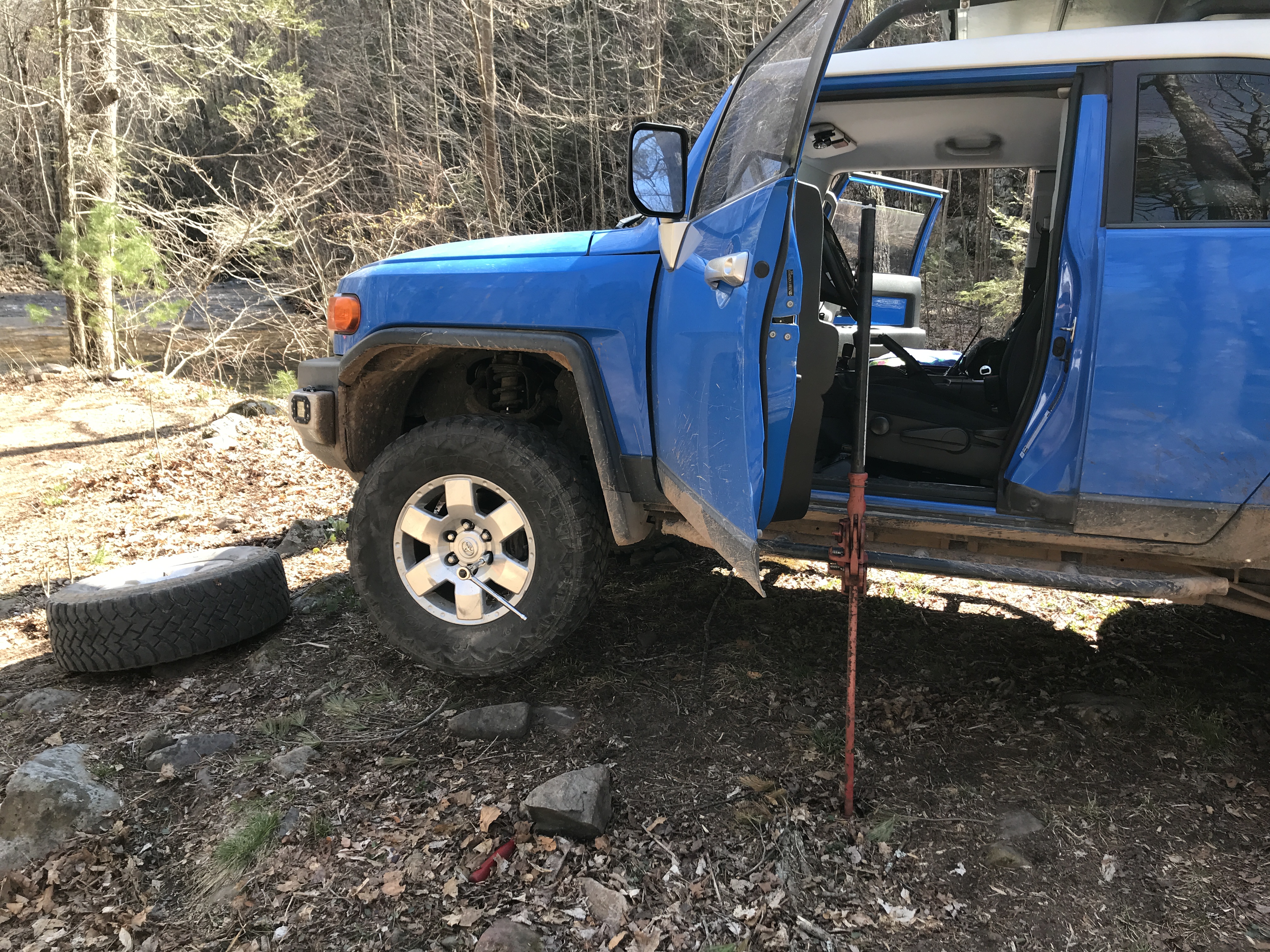

It's not completely useless without sliders or bumpers as it can still be used as a "come-along," but it may be unnecessary for your travels. You should definitely experiment with the stock jack and see if it suits your needs - it might.
I have carried this Hi Lift for almost 20 years now just this past weekend used it for the first time. The truck it was originally purchased for had steel bumpers. The two rigs I've had since then had rock rails. Having sliced a sidewall on the trail, this combo made quick work of the tire change.
I also carry the Jack Mate to simplify attaching chain and using the jack as a come-along. You should read up on them, as well as check out rock rails or sliders for your rig. They are a nice addition, and there are styles to fit the look of any build. In the mean time, you should also look at exhaust jacks. The Xjack is probably the most popular, but it's also probably the most expensive. Shop around, as I believe there are better values out there.
I also carry that Jack Mate to simplify attaching chain and using the jack as a come-along. You should read up on them, as well as check out rock rails or sliders for your rig. They are a nice addition, and there are styles to fit the look of any build. In the mean time, you should also look at exhaust jacks. The Xjack is probably the most popular, but it's also probably the most expensive. Shop around, as I believe there are better values out there.

I had one in my Grand Cherokee that had sliders, and I used it in the same way as Kevin did with his FJ above. In my case the Jeep was buried in mud up to the rockers. Two trucks couldn't budge me. Luckily I had a shovel, and we found some planks in the woods. Dug out enough to get a plank and the high lift under the rockers, then one side at a time lifted the jeep till the wheels were out of the mud. We stuck the planks under the wheels, then drove the thing right out. We had to lift it pretty high as my swaybars were disconnected and solid axle Jeeps have quite a bit of droop. I doubt this would have been possible with any other type of jack, especially not the stock jack (I had to keep a thick piece of wood in the jeep to put under the stock jack for it to even work once I put on bigger tires)
Also, note that Kevin has his door open in that pic. That's good hi lift technique, as the jack can pivot inward as you're using it, and can put a helluva dent in your door. I had my door open when I used mine too for that reason.
