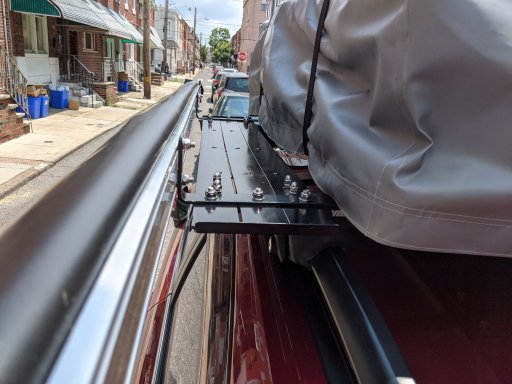

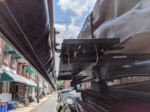

I will make a reccomendation: don't waste too much on a high end roof rack for a RTT.
Go get craigslist Yakima Roundbars for 1/10th of the cost. You cant see them under the tent, and steel round bars are a lot stronger than the aluminum ones. The length of the bar is going to be something you want to work with, and you can cut round bars to size. With my RTT on a crosstrek I went with 52" that was plenty of room for the rtt, and about 10" of extra space for a custom shelf/awning bracket. On the shelf, next to the rtt(drivers side)behind the awning, I have enough room for 2 jerry cans, or 2 camp chairs and table etc....

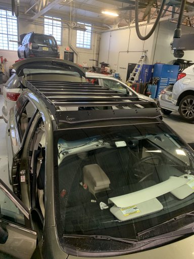

Thanks for the tips/ideas everyone! I've learned a lot in a couple weeks now, most importantly... Subaru changed the factory rails bars on the 2020! Yakima jetstream bars were recommended to me by a rack dealer...we looked them up, and they haven't made anything yet for the 2020! Other brands haven't either.
I learned that Prinsu will work and seems to be a popular option. Looks super clean, but installation looks pretty gnarly, tearing down the headliner. Not sure it will ever fit the same again if I go that route. I saw a video of a frontrunner slimline II, which appeared to be mounted on the Outback factory rails, but the model year was not disclosed. I really like the look of the Frontrunner...very low profile, and lots of attachment/accessory options.
I found another rack dealer, explained my situation, and they do custom, tailor-fit racks. They think they can do something for me like the Frontrunner, but will likely remove the factory rails. Sounds good to me at this point! I'm waiting on a call back to schedule an appointment. I'll keep you posted!

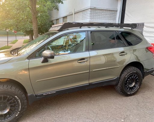

KJ7FTV
I have a 2017 Outback with a CVT RTT, it weighs 125 lbs. I was told by CVT they did not recommend their tent be used on the crossbars. Dynamic load with wind during driving conditions can overload the crossbars. I looked and found that Front Runner made a rack for mine that bolted where the existing tie down brackets are located. It was easy to install and no need to even get inside the car, bolted right up. Has workers great and I love it. DOWNSIDE is $$$$$$, it's expensive. Not sure if they make one for the newer models. Link in my signature leads to my build. I have traveled many miles with he RTT attached and love it. The rack and RTT has even made it to the Arctic Circle and the Arctic Ocean in 2019.

How difficult was the headliner to put back up? I love the rack.
