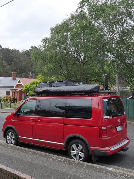

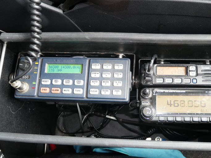

I've posted here before regarding my Barrett 550, which is intended for use on Australia's remote area SSB radio networks (RFDS and VKS737).
I've now reprogrammed my radio for Amateur/HAM frequencies. It's slightly clunky to use, as the radio still uses channels, but they can now be programmed from the front end.
The autotune antenna allows me to talk on he move, provided there are no low power lines or overpasses.P1000311.jpgP1000309.jpg
