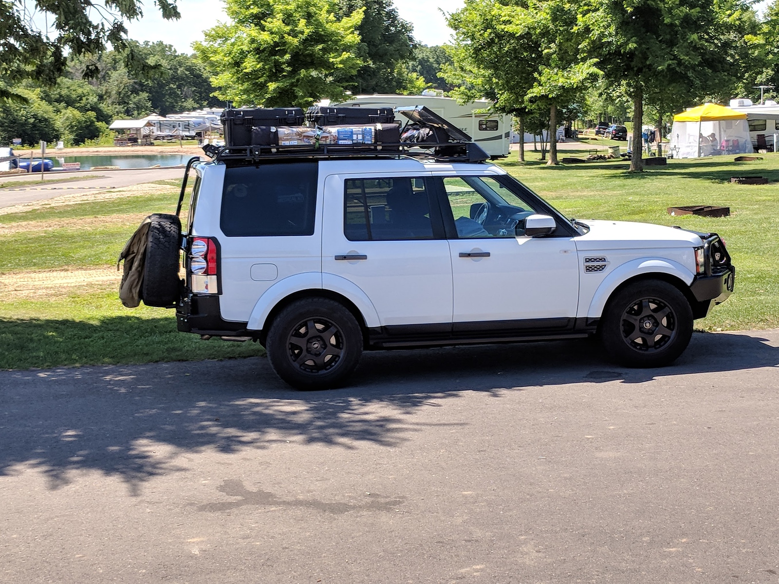

It is too bad that the 4 door jeep wranglers have such limited payload. My LR4 has pretty good payload but when fully loaded up I am up to GVWR. I have more armor than I need though, and have considered removing the transfer case and gas tank skids. Most of what I do in the midwest where I live is super tame and im not bashing rocks anyway. I do strongly value my ARB bumper and rear steel bumper. I take the rear tire and jerry swings off my bumper when im not on a trip, mostly to make using the tailgate easier. The bumpers are critical for animal strikes (I've hit a few deer already on this thing) and also good insurance for minor traffic issues.
I encourage people to keep an eye out for those truck stop CAT scales. You can weigh your vehicles on them, you don't have to be a big rig.
2013 Land Rover LR4 -- Curb weight 5,655 lbs -- GVWR 7,200 lbs. (it's basically a 3/4 ton truck, the air suspension makes it work pretty well, keeps things level and at the correct ride height)
Fully loaded, all gear, full fuel, all armor, kids, water, etc... Im just pushing GVWR! That water, a full fridge and ll this crap really adds up! Plus the kids aren't getting any smaller.
