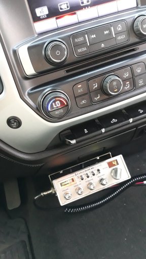

I've got a Cobra 25 with weather. With all the sh!t talk on channel 6, for example, and all the nothing on some other channels, I like to be able to switch to weather for either the info or the background chatter.
Mounted under-dash to the ashtray door as it is, when it gets bumpy out there, the ashtray sometimes flops open.
Thank you! Sounds like it has helped you many times.
